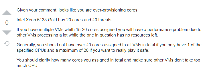

So Epicor doesn’t know how to use the full 12 cores in the Gold processor, correct? Interesting if so…
It’s not Epicor that’s struggling. You are running too much on a single VM.
Well your Guest OS will gladly take 8 cores… But I dont think Epicor’s MRP Architecture is the best… like it doesnt use async, parallel tasks (true multi-threading)… I wish I could plugin 10 GPUs and offload MRP to be done in 1hr :slight_smile:
MRP
Oh ok. So that is why you split up into different VM’s for SQL and Epicor. Too much of one thing is never used correctly or efficeiently.
Windows would use 8 cores but with SQL and Epicor all on one VM I think they are going to be fighting over the resources. That’s just my opinion. You’d see better performance even with those CPUs if they were separate VMs.
Yup. Also don’t assign all cores. Remember your Host and its OS need some power too

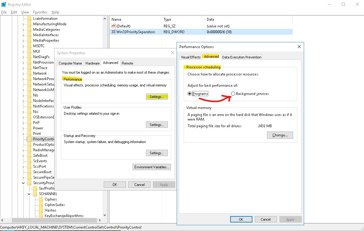

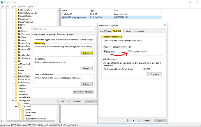

Is the slow response only when you RDP to the server? or is it for all users connecting from the Client?
There is a setting in your server that could cause such behavior. It is called " Processor Scheduling ". In the server, there is a registry entry that specifies if you want the processor to prioritize Programs over Background Services or vice-versa.
If you look at it and the priority is set to Background Services, then when you log into the server (locally or RDP) it could happen that everything is very slow. launching programs, running something that should be fast, all this because your programs have no priority. In my experience this is the reason and not hardware specs. All production servers should be set this way (background services over programs) it makes sense. For test and development environments, where you often log in to it to do stuff, then Programs is a better option. That will avoid frustration.
Give that flag a try before adding more VMs. Having both App server and SQL on the same server is still a valid architecture option for Epicor. Just be sure you add memory limit to the SQL Server, so it does not take all available.
Hope that helps.
I just set it to programs. Thank you for pointing that out! I never would have thought of that! Much appreciated!
Great. If this is your live server, then you may want to put it back to Background Services later on, that should be better for users running epicor client not directly from the server.
Also, if you notice this flag solves your lag/delay running a program on the server, please mark the answer as solution to help others.
