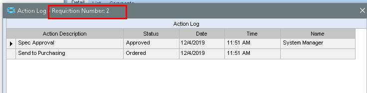

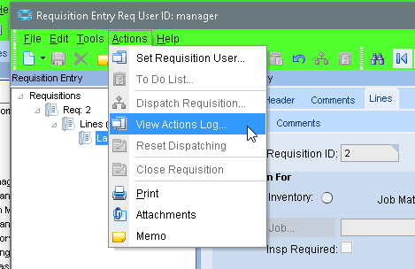

Does V8 have a View Action Log in the Request Entry form?
Here’s what I see. Req #2 was ordered (through the PO Suggestions form).
Req #3 was approved, appears in PO Suggestions, but has not yet been ordered
Yeah it does have the action log, the req that should be sent to purchasing is still listed as pending but does not appear in the suggestions
