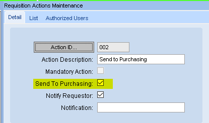

Thanks @ckrusen and @Nancy_Hoyt. Once we have a action with “Send to Purchasing” selected and the requisition is dispatched to this action the requisition should now show up in New PO Suggestions correct?
This is where we are having issues…nothing is showing there. Even after doing Generate Suggestions.

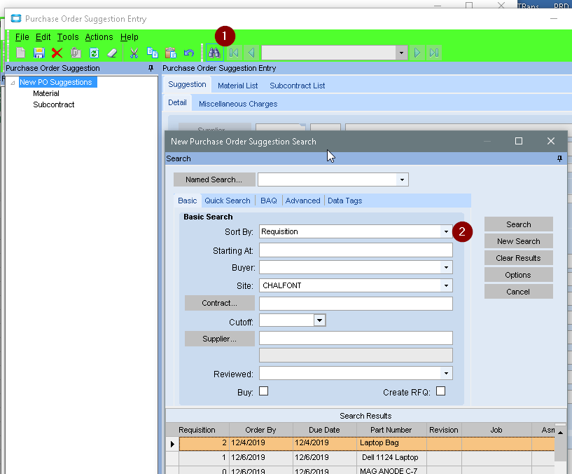

But whe searching for it in New PO Sugg entry, you have to use the binoculars (1), then change the sort by to Requisition (2)
Ah! We’re making progress now. I see purchase suggestions by using the binoculars, however my requisition is not showing up :frowning:

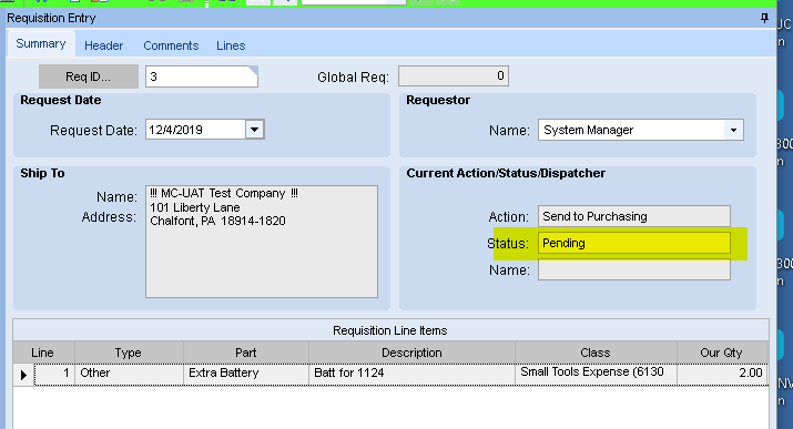

What shows as the status in the Purch Req Entry?
edit
and is the Action above the status, the one that submits it to purchasing?
FTR - Everything I’m showing is in E10.1.400. V8 may be different
Yes, the Current Action on the Req is the one that has Send to Purchasing checked and the status is showing as Pending.

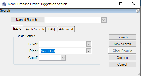

The sort by requisition drop down you showed in a previous message? I don’t see that in Vista. This is what I see after I hit the binoculars:
Perhaps V8 requires running the Generate Suggestions.
Tried that too…it generated suggestions just no Reqs came through.
