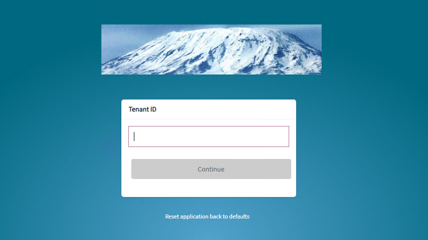

Heya Folks, I just was playing around with our new Kinetic environment and thought…we branded the classic client logon screen…can we brand the web login?
As a server administrator (on-prem) navigate to your IIS directory where the Kinetic application was installed. Then navigate to the \Server\Apps\ERP\Home\assets\img directory. Replace the default-logo-epicor with a png of your choice then recycle the IIS pool, and bam! You now have your image on the login screen. If there is a way to to this via the interface, let me know!
