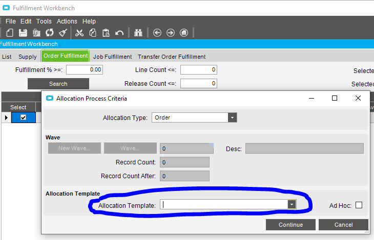

Create Warehouse Team and select the required employee
Inventory Management -> Setup -> Warehouse team
Create Warehouse allocation template and assign the required warehouse team.
Inventory Management -> Setup -> Allocation template
From the fulfillment workbench select the required allocation template while allocating for picking.
Inventory Management -> General Operations -> Fullfillment
