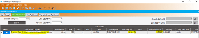

I am doing a Wave Picking for a part; There is enough on-hand qty, bins (not all) are marked as Wave Replenishable , and “regular” fulfillment does work when doing Allocation. Only Wave doesn’t work and I get a message: “Process Error-release xxx/x/x zero quantity fulfilled”

It appears that the Wave does not work when an Allocation Template is used.
When I use the “ad-Hoc” and I use the same exact parameters as I used in the Template, the allocation in executed successfully.
I have to conclude that there is a bug.
I appreciate your reply. It worked for me with ad-Hoc as well. thanks!
