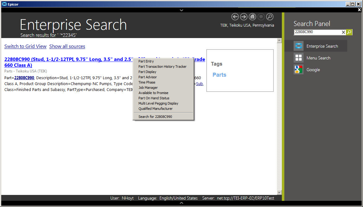

When get a part match, I can right click and see open with programs… why no part tracker available (see screenshot below)? We have limited users with privileges to do part entry. Can we change this somehow?

With regards to the context menu, Did you right mouse on the actual part number link or the heading link? You need to configure like fields in the BAQs for Enterprise search

For the context menu, I wasn’t sure which I clicked on, heading link or part num, it doesn’t seem to matter, both bring up same options for which programs to open. I would think that the like field is configured for part num since all of the part programs want to open via context, except for part tracker for some darned reason…

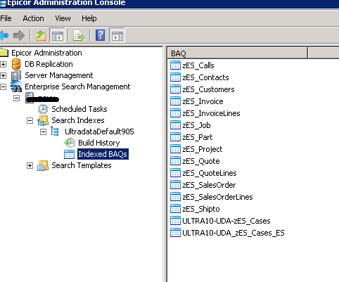

This is probably a dumb question, but how do I see the BAQs for enterprise search? Are they named something particular and avail in BAQ designer?
Nancy
We are using E9 so I am not sure if they have changed or not in E10, but in E9 you can see the BAQs in use through the Epicor Administration Console.
You can look at the properties of the BAQ for the search by right mouse clicking.
All Enterprise search BAQs have an Export ID or Query ID starting with zES. You can add BAQs as you can see in the screen shot, Of course if you are using the zES BAQs as a starting point you have to copy before you can edit it. So in short they are available in BAQ designer.

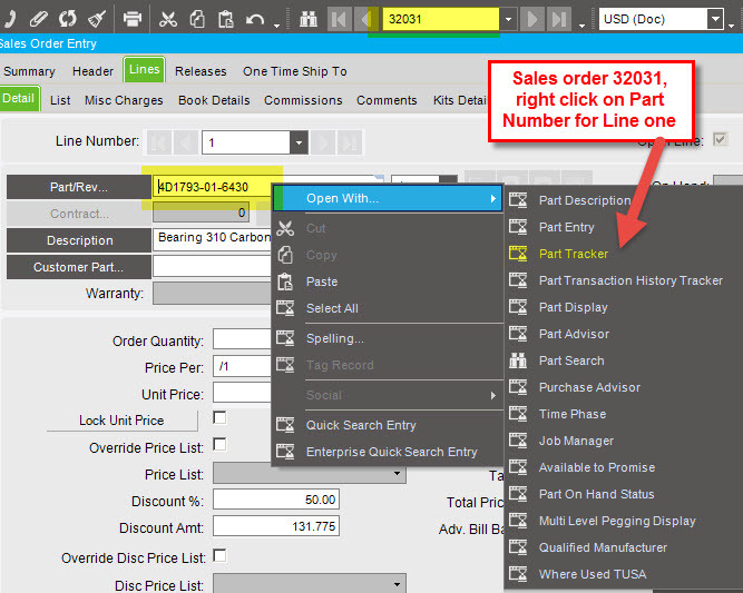

As far as the context menu, I still have a problem. Please see screenshots. I have Part tracker available on Part field in sales order (picture 1), but then when I use enterprise search and right click from found data for the sales order line (picture 2) I don’t get Part tracker. Therefore, system doesn’t seem to use the same context menu items for Part Field on a sales order. Any thoughts on why? Most people don’t have part entry privileges, so of course the tracker being here on the enterprise search with the open with is important.

That should be working, but there can be a lot of uknowns, I assume this is hte same user? I ask because context menu changes can be personalizations or customizations and it may not be picking up personalizations. it is also possible I"m mistaken but the list is being driven by the data available to it from the context menu logic inside the E10 client and that is supposed to include the customized context menu.

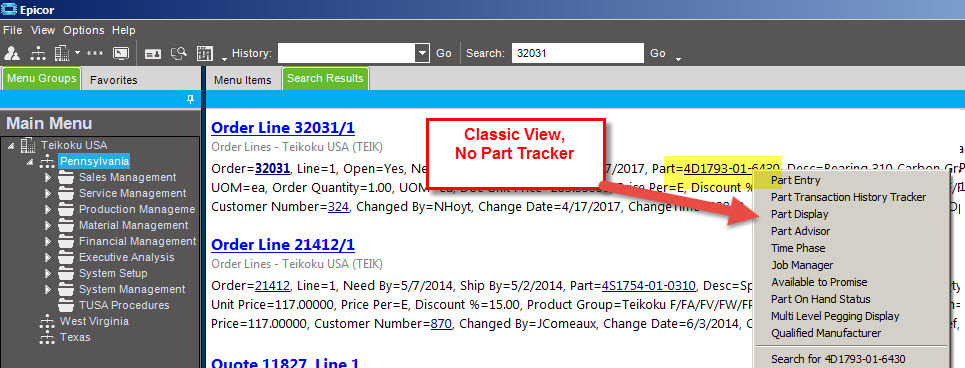

Can you tell me: what version you are on? Also can you try in the classic menu and see if you get the same or different result?
Hi Patrick,
I am working on testing in Version 10.1.500.15. Classic view gave same results (screenshot 1).
However, I pulled up the context menu maintenance to see what’s assigned there, any customization/personalization. I noticed that the Part Tracker was called using process calling ID SVGO0013. I think that this was a default from 905702 version, as I have no recollection of ever assigning this.
For Part tracker context call I changed to assign Process ID OMGO3004 (from order management part tracker) and IT WORKS NOW! I noticed in our upgrade that all of the old trackers that were all in the Executive Analysis folder / Trackers are not there now and only some new ones are in there now. Perhaps the SVG process calling programs were ditched?
