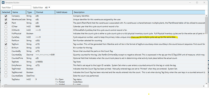

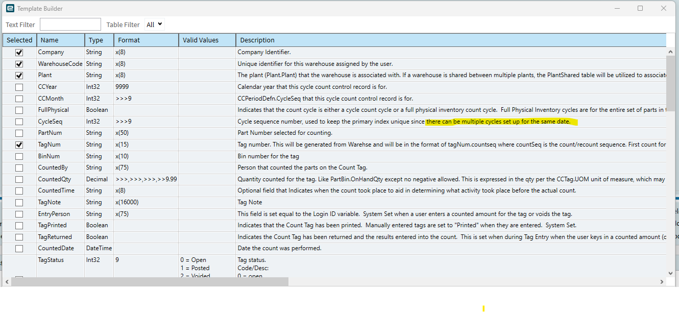

Are you open to writing a little code that generates the cycle count records you want? You could use DMT to run them to create the cycle counts that the system will not let you create/process the way you want.
I’ve not played with it in this way, but from the template generator in DMT, it seems it allows for a CycleSeq value.
I agree with Mike. You don’t have to use the Kinetic Cycle Selection process. At a previous gig, we managed the parts selected and pasted them into the cycle. This facility hasn’t done a physical in ten years passing every single audit.

I like the idea, but… what is the name of the DMT?
Your pic has a TagNum field, so I assume the pic is Count Tag, and I do have that in the DMT.
But I don’t see anything else cycle-related. No period definitions or schedules etc.

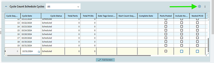

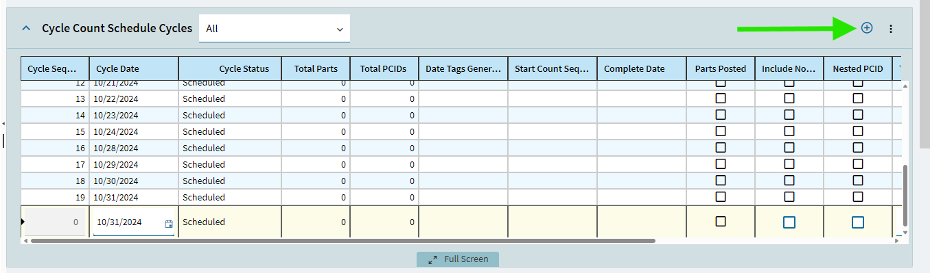

Oh, well I feel stupid. You can create additional cycles within a schedule on the fly.
Since the system auto-creates the cycles based on the calendar, and one per day, I just assumed that it was a system restriction. It is not.
Well, it will still require some manual manipulation, but it is doable with a paste-new, etc. No need for overlapping schedules.

It’s the Count Tag DMT, where the assumption was that you created the cycles prior to the DMT. But since you found where to activate the CycleSeq field I pointed out then you’ve got it covered! :slight_smile:
