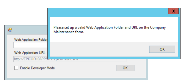

Please suggest , System is throwing below error " Please set up a valid Web Application Folder and URL on the Company Maintenance form."
If you look at the help for the field, it tells you that should be pointing to the physical inetpub folder for your instance of EWA

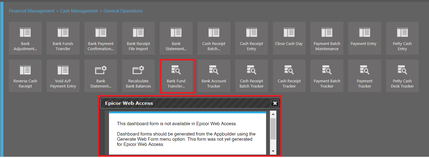

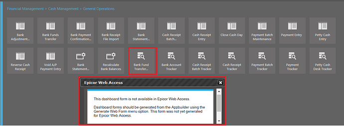

We have “Generate Web Form” for Dashboard. But when we are trying to open through EWA. System throwing error (Refer to below screen)

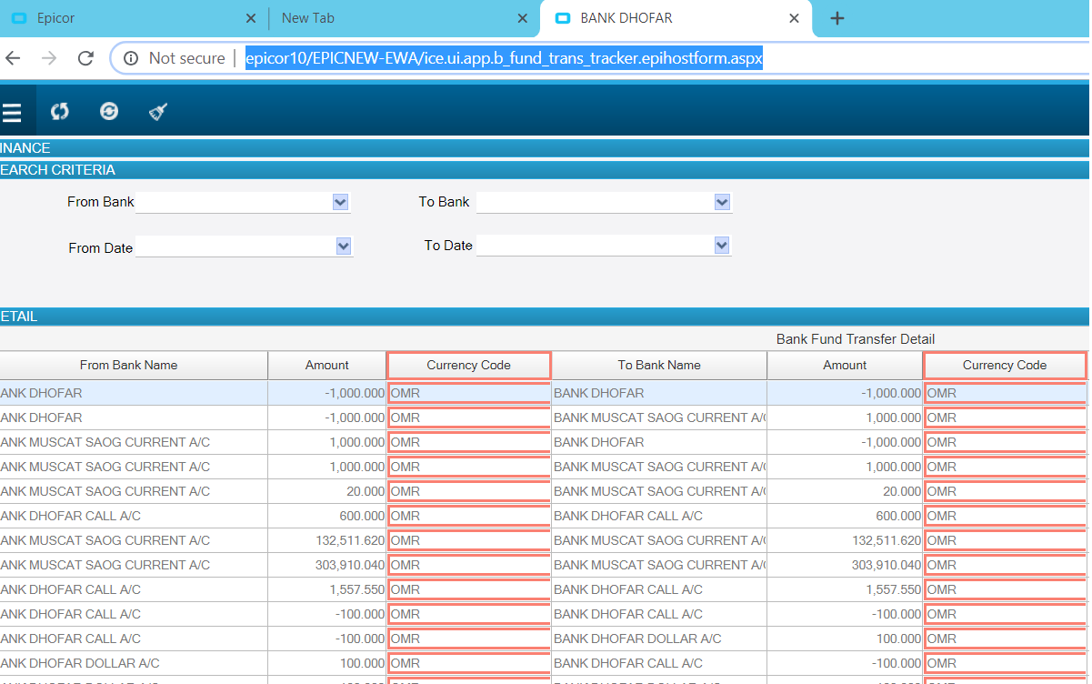

When we are directly putting the URL in Web Browser, It is working fine (Refer to below screen)
http://epicor10/EPICNEW-EWA/ice.ui.app.b_fund_trans_tracker.epihostform.aspx

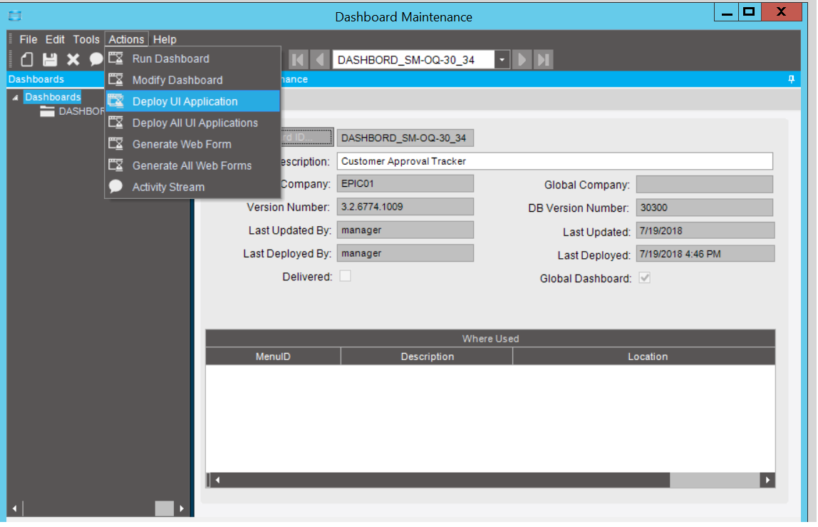

Dashboard is working fine now. I did following changes
Deploy UI Application (Refer to below screen)
Generate Web Form (Refer to below screen)
- Recycle IIS application.

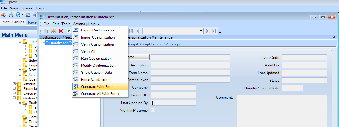

For customized and UD forms we processed the below steps
- Verify Customization
- Run Customization
- Generate Web Form
While Generate Web Form, System is throwing below error
