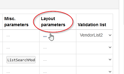

So, the DFD is pretty busy. A fair amount of fields. This leads to a lot of scrolling and not he best UI. So looking at these 2 fields, each are only a few characters long. All of this field is empty space.

You can use that exact “Layout parameters” field you’re referring to to design the input portion of the DFD. I have never actually used these so I don’t know the specific beyond what can be found in the help section on the Ancora website. I’ve pasted it below for quick reference.
Layout Parameters
By Default, each Form Field will use the length of the entire row, using the Layout Parameters, a Document Form Definition can be configured to mirror the same layout as the document. Click in the cell to activate Layout Parameters controls.
New row: This creates a new row in the form beginning with the select field
Min width: This is the minimum number of pixels to display for the field. This can be left at the default value of 0
Max width: This sets the maximum width of the field.
Note: the size of the fields will dynamically adjust based on the number of fields added to a given row.
Note: the layout parameters are only supported in the desktop version of verify at this time.
See an example form layout below, where each row in the Document Form Definition matches the the corresponding document.
Ah, that’s the problem, we’re cloud. Even if I use these, it doesn’t seem to do anything. I wonder if it’s just a legacy field hanging around when it’s no longer used.
