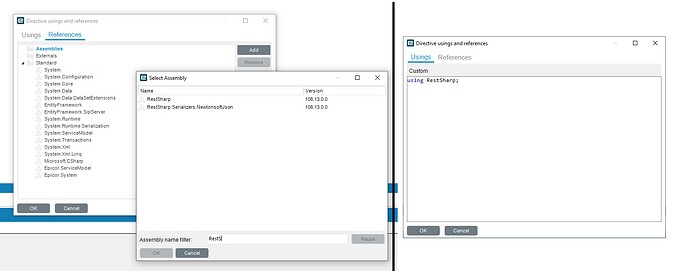

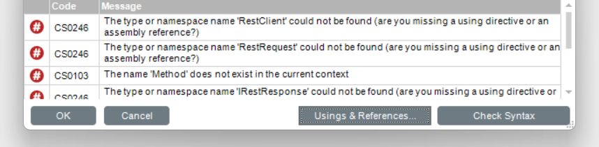

I have the BPM setup and I tired adding the Restsharp code from postman to the custom code function in the BPM. But I get this error(s):
From what I’ve read, it looks like I need to add the restsharp dll to my externals folder. I’m assuming that applies to locally hosted Epicor. But there must be away to add the restsharp dll to epicor cloud. Any ideas?
Just for anyone else that runs into this issue. We cannot run the restsharp code in the cloud environment. Which means, no webhook calls.
Alan - Did you have an EpicCare ticket number for this issue? You should be able to reference the RestSharp DLLs from BPM and Functions.
I did and the account manager said it was not possible. I can find the ticket number if you’d like.

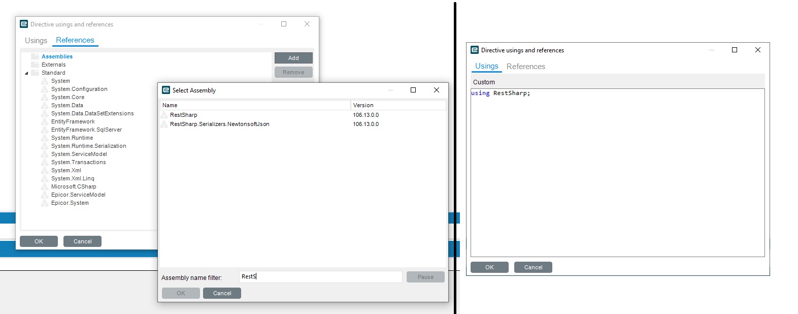

Did you add it to the assemblies?
It should be included by default now.
Hmm I’ll have to look into it and see if it works now.
The RestSharp DLLs were included with the Server installation starting with 10.2.700.
