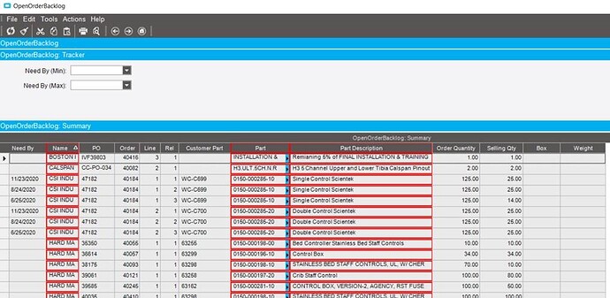

The band aid solution currently providing us a schedule is a BAQ that Comtec made for us when we first signed up and it is better than the canned reports like Scheduled Shipments or Sales Order Backlog Report. I have attached a screenshot below:
But Comtec just added the BOX and Weight Field to this without it being a field I can add the data every week from what the production floor boxes off, so I take this and Copy to Excel then format it, add in the weeks data then vlookup from the previous week because there is no paste update in excel that I am aware up, then custom sort Customer Name then Need By and also Concat(Order-Line-Rel) and add a column for SN/LOT

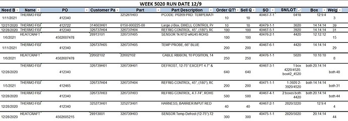

The a manually added data into this new spreadsheet has to be the right font size and other preferences so people can see whats shipping this week, whats already boxed and what orders are open that need to be boxed. Or Else lots of complaints. So I utilized Macros for most of the formatting operations but didn’t have a lot of success filtering and custom sorting with macros.
Here a screenshot of what the end spreadsheet shows.
So any luck with how I might be able to eliminate the need to Copy to excel from the BAQ. Have any of you utilized Staging in the Customer Shipment Entry? To keep track of all the boxes we write down SO#-LN-REL, CPN, C PO#
