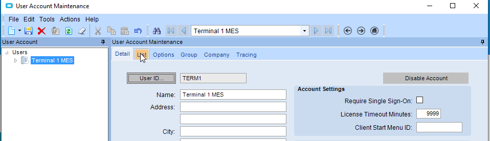

Could check this in User Account Security Maintenance. I think default is 30 mins though.
Ever think about setting up terminal services, and having them run as remote Apps?
I am trying upping to 999 to see if that has an effect.

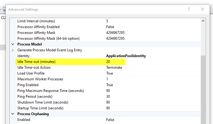

Maybe look in the settings for the App Pool in ISS
(Just a wild guess)
