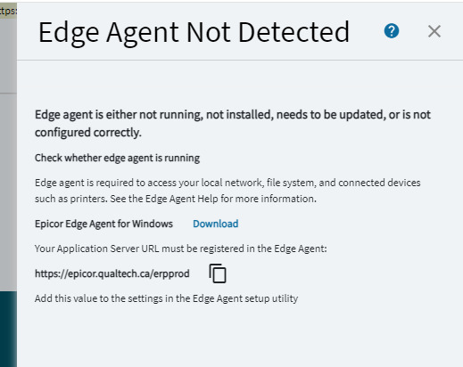

Here is what I have when clicking on it in the web version:

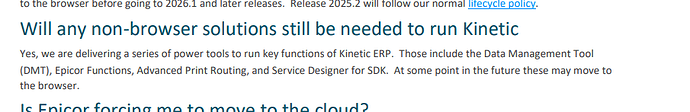

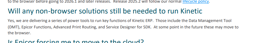

I think Functions Maintenance will be apart of the “power tools” package, which is supposedly sperate from main Kinetic.

Never heard of power tools but if anyone has more info, would be happy to hear about it.
I’m wondering if current cloud users are able to access Epicor Functions Maintenance :thinking:
We are on cloud and we can. We just have to use the classic client, not the browser.
more info on power tools here:
Thank you ! That definitely answers my question and I’ll read that thread to find more info
