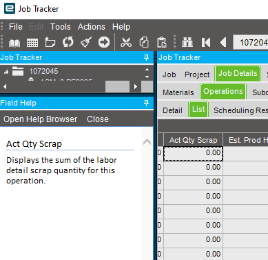

For some reason the Act Scrap Qty doesn’t display the sum of labor detail scrap like its supposed to in our Job Tracker. It just shows 0 for each operation.
I created a real basic post-processing method directive on Erp.BO.JobEntry.GetDatasetForTreeView so that the grid will display the actual value.
