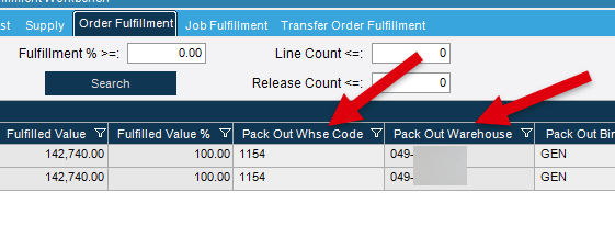

In fulfillment workbench, there is a field called “Packout Warehouse”. I’m trying to figure out where this is being set. I would think it would be the warehouse for the order on the release, but that’s not the case. The other place I would think would be the site configuration defaults. Now, those match this row, however, if I change that default, that doesn’t change what shows up on the row. But I don’t know if there is something that generates these rows that I would have to run before that gets updated. Does anyone know how that’s controlled? I’m automating some of the picking process to help with large volumes of small packs, and I want to keep as many defaults as possible. But this one doesn’t seem to make sense to me.

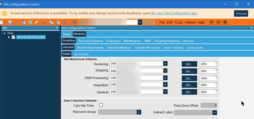

So I think I figured out what the issue is. It uses the default warehouse from the sites. (Like I thought). Show here.

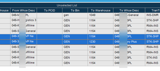

The lines highlight show the same part number, 2 different orders because I made a new order to see what the heck was going on. The new order, worked like I expected (uses the sites default… it would be better to use the order… but whatever)

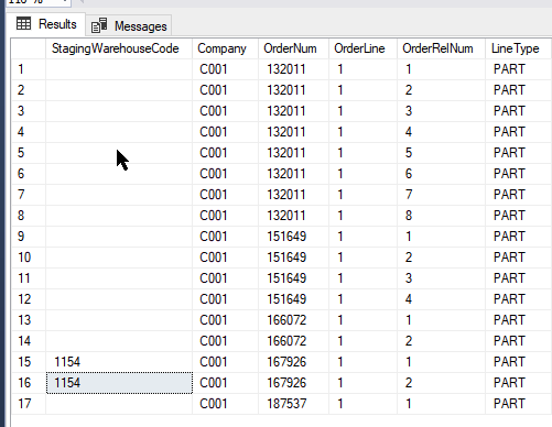

There is a field on OrderRel that is shown nowhere that I can find that writes a staging warehouse. Then the system uses THAT to make it the default to from then on…
I proved it by clearing out the staging warehouse for those records in the database, when when I search for the parts in the fulfillment workbench again, the packout warehouse is the default site warehouse.
