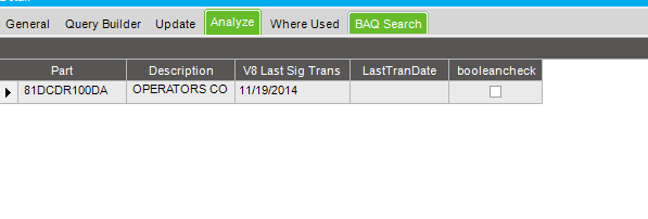

I have a situation where I need to test for a “blank” date field and cannot get a returned value.
It seems easier to explain in this < 2 min video than typing a long winded explanation.
Essentially if my max(Trans Date) from the subquery is ____ then I want to use this other date where “____” from the subquery is not returning any of the following: ‘’, ’ ', or Null.
(note I also tested for ‘1/1/1900’)
Thanks in advance for any advice.

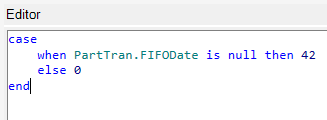

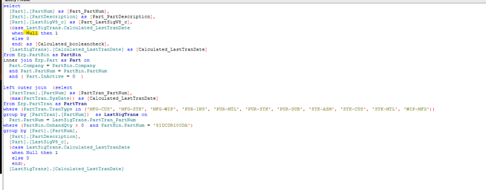

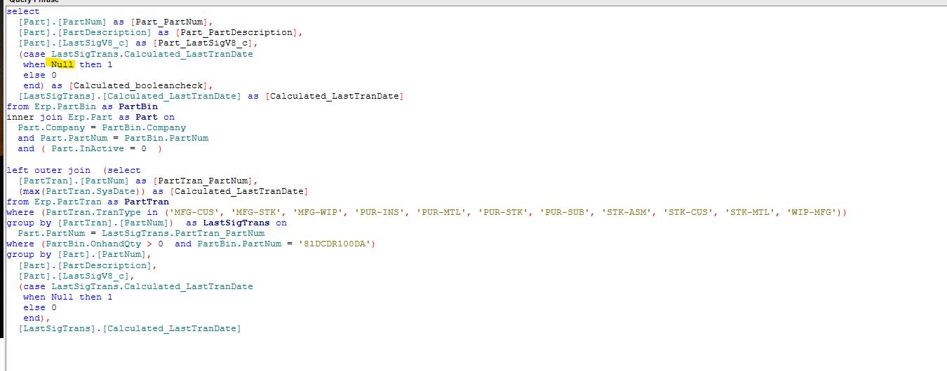

Agreed. Here is an example showing the BAQ test for null and the output not recognizing the null (Boolean should be true).
look at the link I posted above. You cannot write When Null then…
SQL uses a special IS NULL syntax to compare values to null. You will need to change your Case statement to:
case when LastSigTrans.Calculated_LastTranDate is null then 1 else 0 end

Started with the IS NULL, but the BAQ Editor doesn’t accept it.
