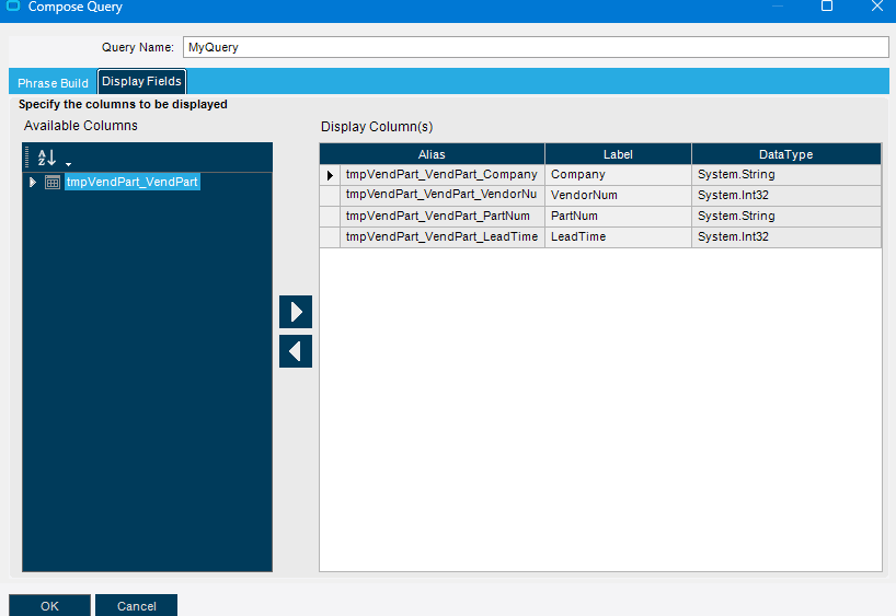

In a bpm “Update Table By Query” is there a way to select the max date? for example in the vend part table there are many records for a part and all have the same vendor number but each on has a different effective date, I want to select the one with the most recent date.
Yes, just group by the part number, and get rid of the effective date field. instead put in a calculated field of max(effectivedate). Then you should only get one record per part with the biggest (latest) date.
It doesn’t let you do group by or calc field in her
Ohh I missed that important part. In the BPM widget for Update Table by Query, you can’t do any grouping or calc fields. I think you would have to generate this in a calculated field in a BAQ. But you probably aren’t using a BAQ if you are just writing a BPM. Hmmm… Maybe try to create a function. You can call functions from your BPM.
