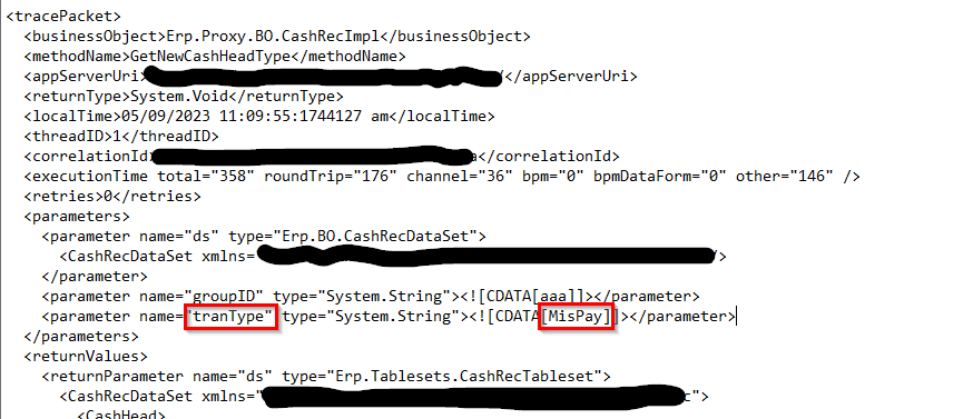

I need to create a BPM against the Cash Receipt Entry New Misc Pay. I am having difficulty determining the correct Method. Can someone please help? I tried to create a trace log but no luck.
Thanks in advance.
Thanks in advance.
It is CashRec.GetNewCashHeadType. When you do a new misc. payment, it sets the param tranType to ‘MisPay’.
