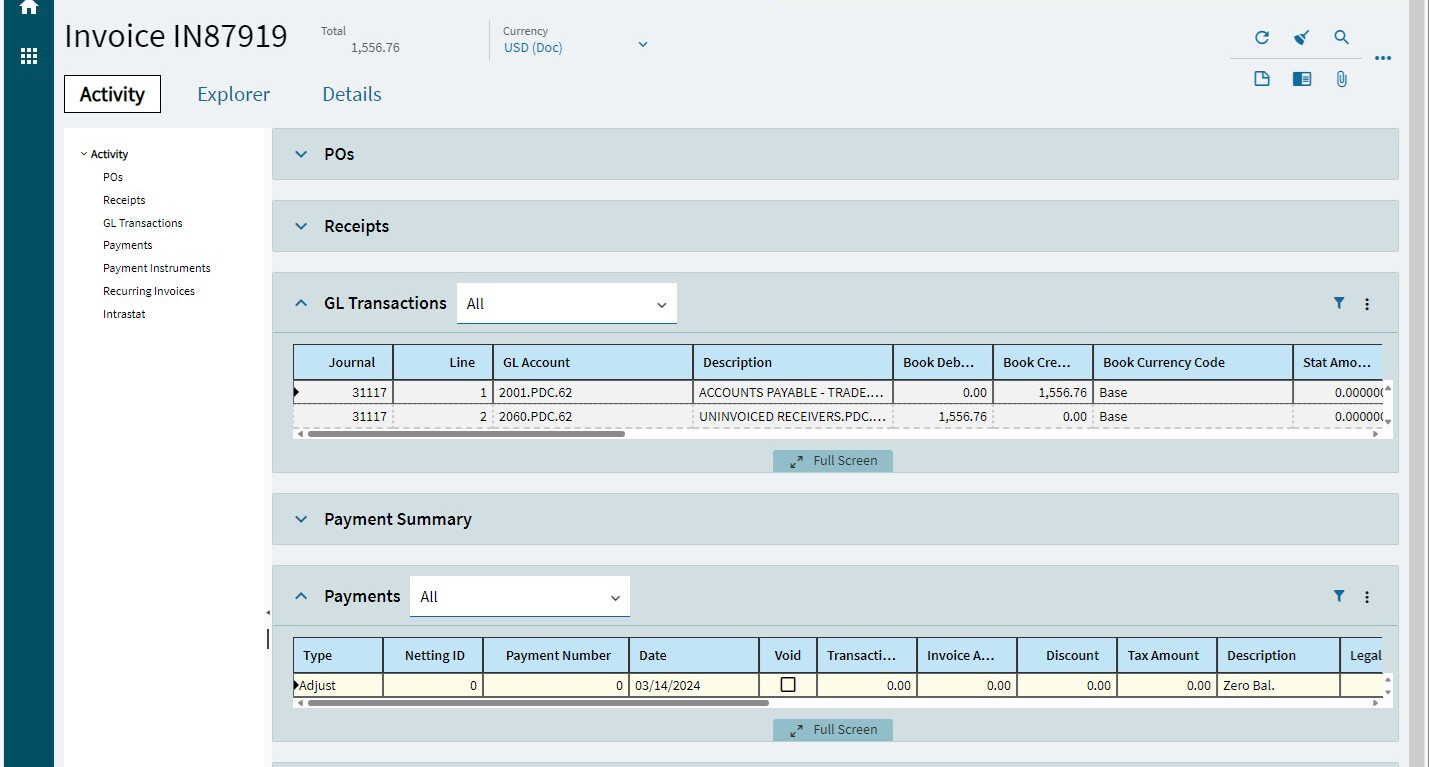

What is this AP transaction?
I think this should be simple enough - what is this “Payment” transaction?
It says Adjust, but it’s for zero dollars. No one in accounting recalls doing this.

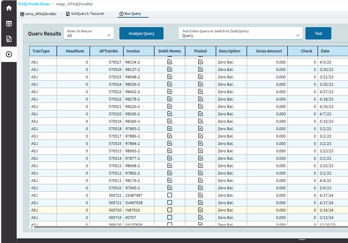

I did some BAQ-digging, and There are 1,642 occurrences of this. Every one says “Zero Bal.” (after 2020) or “Zero Balance Posting Close” (prior to 2021). Most - but definitely not all - are debit memos.

I agree and after my meeting I’ll check our system. Do you have the BAQ you used? Would speed up us checking.
SELECT * FROM erp.APTran
WHERE TranType='ADJ' AND Description='Zero Bal.'
I have a few too ~2571 rows
Here you go. It’s just where APTran.TranAmt = 0
temp_APAdjZeroBal.baq (10.5 KB)

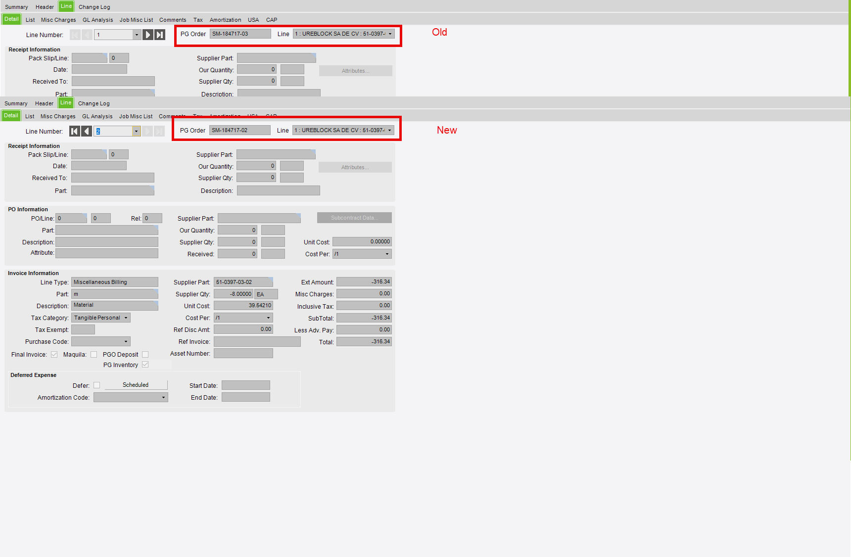

Looks like a zero dollar correction invoice will do this. Basically if you are fixing something else in the invoice other than the dollar amount.
When it posts, it posts an APTran (payment) of Zero Balance to close the invoice.
IE: WE created this correction to change a UD field in the AP invoice (do’nt ask why) and it created that Zero dollar AP Tran(for closing it)
It is basically an internal triggering mechanism to “Close” the AP invoice (when it has zero dollars). Epicor didn’t feel like writing a custom “close invoice” routine. So they just apply a zero dollar payment #Clever

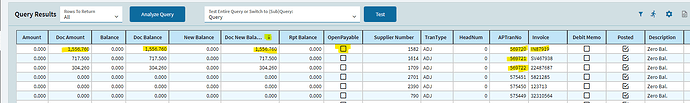

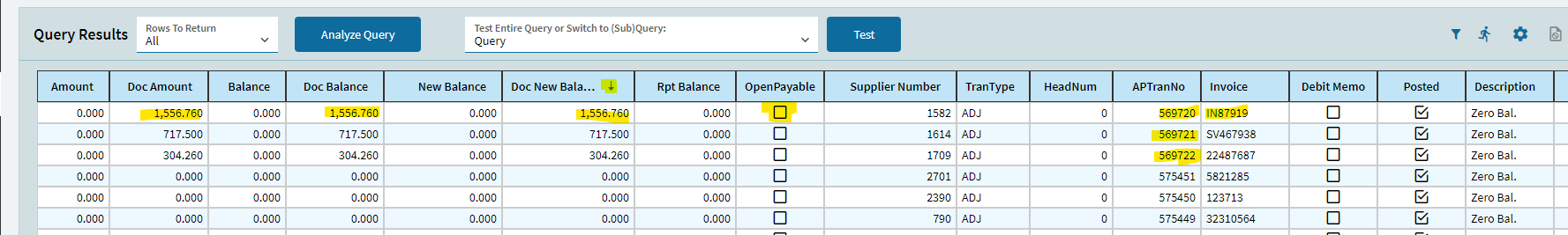

Support did help me find that there are 3 transactions that show a “Doc” balance when the regular balance is zero. (AP Invoice Tracker must be showing the “Doc” version.) But we never paid the invoice. Also the invoice is marked as OpenPayable = FALSE, which take it off of the AP Aging report (not good either).
Also note that the 3 tran numbers are sequential.
Finally tried this, and I agree. I couldn’t get it to leave a balance, but it does do the “Zero Bal.” transaction.
I won’t ask why you did the change, but may I please ask: why didn’t you use AP Posted Invoice Update instead? I’m assuming it will not allow access to UD fields?
Bingo it only allows access to some fields. But more importantly we have business process (BPMS) that run on Invoice Post that do a bunch of magic we didn’t want to have to recreate.
