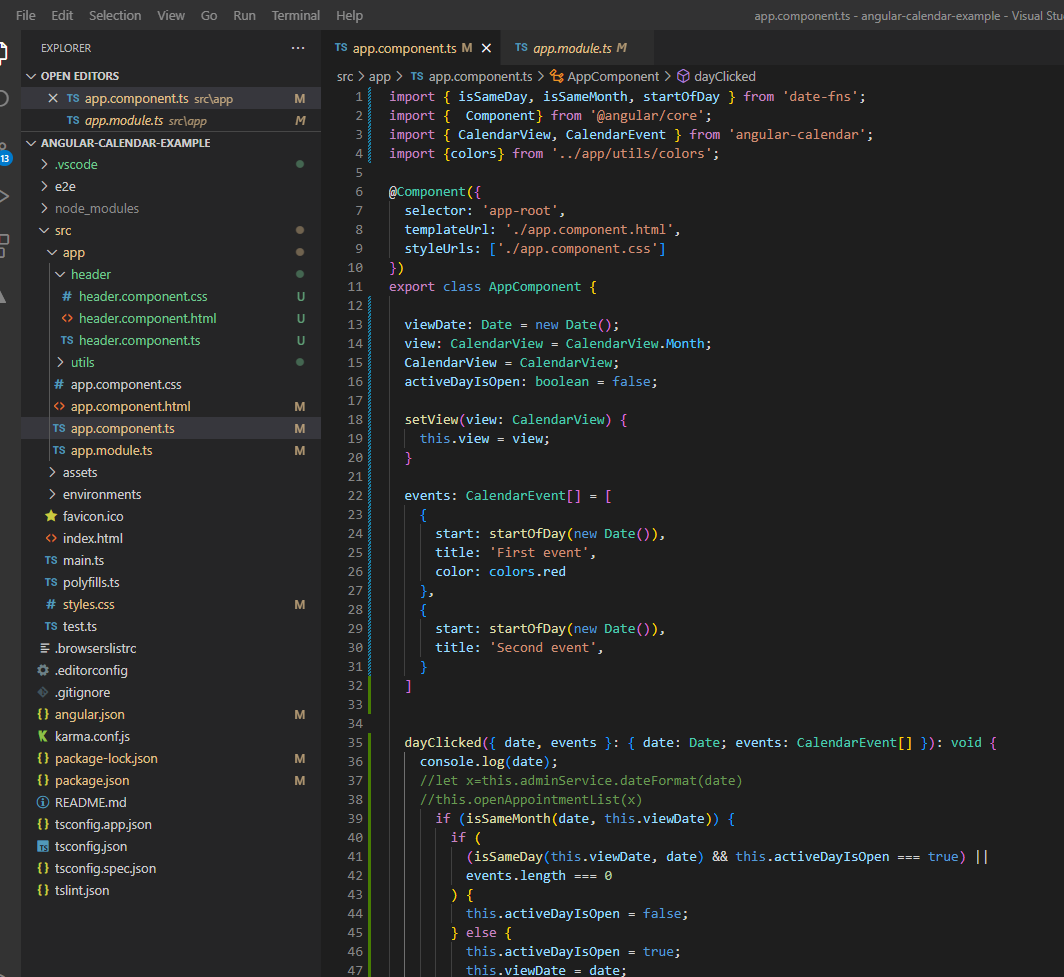

Sample TypeScript inside a component:
dayClicked({ date, events }: { date: Date; events: CalendarEvent[] }): void {
console.log(date);
//let x=this.adminService.dateFormat(date)
//this.openAppointmentList(x)
if (isSameMonth(date, this.viewDate)) {
if (
(isSameDay(this.viewDate, date) && this.activeDayIsOpen === true) ||
events.length === 0
this.activeDayIsOpen = false;
} else {
this.activeDayIsOpen = true;
this.viewDate = date;

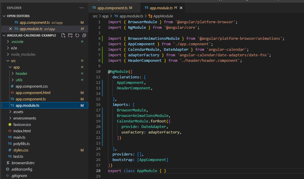

Angular apps are build on Components (which are a grouping of CSS for page styling, HTML for page rendering/markup, and TypeScript for business logic). Components are referenced in other components and all served up by the main component app.module.
Main App Component TypeScript:

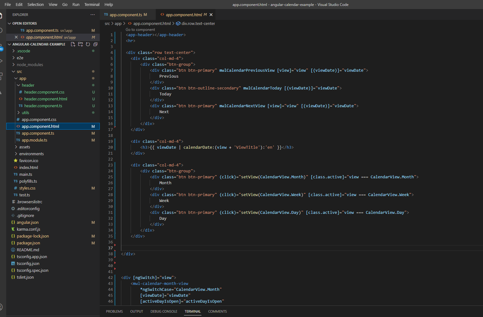

Main App Component HTML (view):
Notice how the first HTML in this component is referencing the Header component of this application, referenced by . Thats how individual components are consumed.

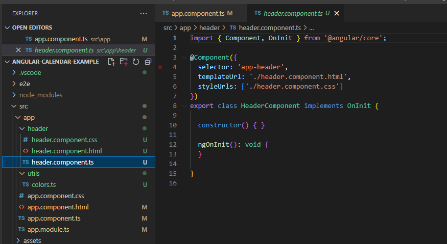

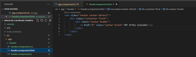

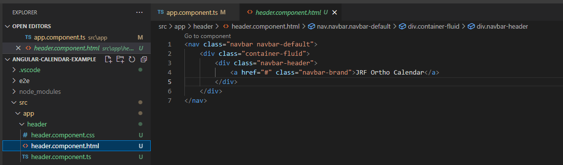

TypeScript file of Header Component:
HTML file:
It’s got its dependency injection and methods and constructors, etc. like any other app.
