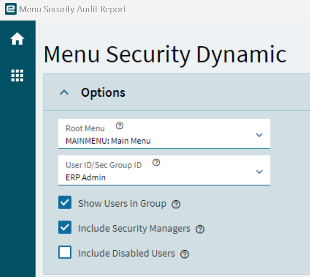

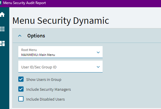

there is a “menu security audit report” you can try. id apply some of the filters as the full log is alot of data to dig through…

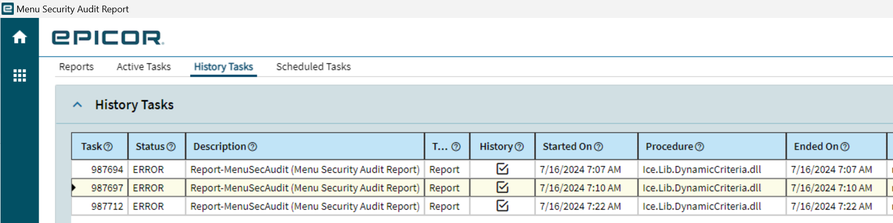

I tried to run the audit report and it errors out with no records available regardless of filtering to a single menu and/or a single security group.
Maybe you don’t have security privileges to run the security report?
10 Dwight Schrute Quotes To Prove He's, Fact: Everyone's Favorite Character On 'The Office'
What is the error (task log) details in the System Monitor with those failed reports?
I am a System Manager. There is no error related to my security access.
The log is as follows…
Program Ice.Services.Lib.RunTask when executing task 951217 raised an unexpected exception with the following message: RunTask: System.Data.SqlClient.SqlException (0x80131904): Cannot insert the value NULL into column ‘UserName’, table ‘@userAccess’; column does not allow nulls. INSERT fails. at System.Data.SqlClient.SqlConnection.OnError(SqlException exception, Boolean breakConnection, Action1 wrapCloseInAction) at System.Data.SqlClient.TdsParser.ThrowExceptionAndWarning(TdsParserStateObject stateObj, Boolean callerHasConnectionLock, Boolean asyncClose) at System.Data.SqlClient.TdsParser.TryRun(RunBehavior runBehavior, SqlCommand cmdHandler, SqlDataReader dataStream, BulkCopySimpleResultSet bulkCopyHandler, TdsParserStateObject stateObj, Boolean& dataReady) at System.Data.SqlClient.SqlDataReader.TryHasMoreRows(Boolean& moreRows) at System.Data.SqlClient.SqlDataReader.TryReadInternal(Boolean setTimeout, Boolean& more) at System.Data.SqlClient.SqlDataReader.Read() at Ice.Core.RptBase.BaqDataWriter.WriteTable(QueryRef queryRef, IDataReader dataReader) in F:\_Releases\11.3.100\UD11.3.100.8\Source\Server\Internal\Lib\TaskLib\RptBase\BaqDataWriter.cs:line 62 at Ice.Core.RptBase.BaqDataWriter.WriteTables(HierarchicalQueryResult queryResults) in F:\_Releases\11.3.100\UD11.3.100.8\Source\Server\Internal\Lib\TaskLib\RptBase\BaqDataWriter.cs:line 52 at Ice.Core.RptBase.BaqDataWriter.WriteTables() in F:\_Releases\11.3.100\UD11.3.100.8\Source\Server\Internal\Lib\TaskLib\RptBase\BaqDataWriter.cs:line 44 at Ice.Core.RptBase.ReportDataBuilderBase.WriteBaqTables() in F:\_Releases\11.3.100\UD11.3.100.8\Source\Server\Internal\Lib\TaskLib\RptBase\ReportDataBuilderBase.cs:line 317 at Ice.Core.RptBase.ReportDataBuilderBase.XMLClose() in F:\_Releases\11.3.100\UD11.3.100.8\Source\Server\Internal\Lib\TaskLib\RptBase\ReportDataBuilderBase.cs:line 213 at Ice.Core.RptBase.ReportDatabaseBuilder.XMLClose() in F:\_Releases\11.3.100\UD11.3.100.8\Source\Server\Internal\Lib\TaskLib\RptBase\ReportDatabaseBuilder.cs:line 94 at Ice.Core.RptTaskBase1.XMLClose() in F:_Releases\11.3.100\UD11.3.100.8\Source\Server\Internal\Lib\TaskLib\RptBase\RptTaskBase.cs:line 230 at Ice.Core.RptTaskBase1.RunDynamicCriteriaReport(IEnumerable1 criteriaParameters, IEnumerable1 criteriaMappings) in F:\_Releases\11.3.100\UD11.3.100.8\Source\Server\Internal\Lib\TaskLib\RptBase\RptTaskBase.cs:line 166 at Ice.Lib.DynamicCriteria.DynamicCriteriaReport.RunProcess(Int64 instanceTaskNum, String outputFileName) in C:\_releases\ICE\ICE4.3.100.0\Source\Server\Internal\Lib\DynamicCriteria\DynamicCriteriaReport.cs:line 44 at Ice.Core.TaskBase1.StartProcess(Int64 instanceTaskNum, String outputFileName) in F:_Releases\11.3.100\UD11.3.100.8\Source\Server\Internal\Lib\TaskLib\TaskBase\TaskBase.cs:line 83 at Ice.Hosting.TaskCaller.InnerExecuteTask(IceDataContext newContext) in C:_releases\ICE\ICE4.3.100.8\Source\Server\Framework\Epicor.Ice\Hosting\TaskCaller\TaskCaller.cs:line 113 at Ice.Hosting.TaskCaller.ExecuteTask() in C:_releases\ICE\ICE4.3.100.8\Source\Server\Framework\Epicor.Ice\Hosting\TaskCaller\TaskCaller.cs:line 61 at Ice.Hosting.TaskCaller.ExecuteTask(IceDataContext dataContext, Boolean suppressTransaction) in C:_releases\ICE\ICE4.3.100.8\Source\Server\Framework\Epicor.Ice\Hosting\TaskCaller\TaskCaller.cs:line 41 at Ice.Services.Lib.RunTaskSvc.<>c__DisplayClass30_2.b__1() in C:_releases\ICE\ICE4.3.100.0\Source\Server\Services\Lib\RunTask\RunTask.cs:line 460 at Ice.Lib.RunTask.BpmFriendlyTaskLauncher.Run(String sessionIdPrefix, IceContext db, Action taskRunner) in C:_releases\ICE\ICE4.3.100.0\Source\Server\Services\Lib\RunTask\BpmFriendlyTaskLauncher.cs:line 57 at Ice.Services.Lib.RunTaskSvc.InnerRunTask(Int64 ipTaskNum, Boolean suppressTransaction) in C:_releases\ICE\ICE4.3.100.0\Source\Server\Services\Lib\RunTask\RunTask.cs:line 457 ClientConnectionId:987b601a-01b3-4e0a-b98d-6d81b5f19e88 Error Number:515,State:2,Class:16
