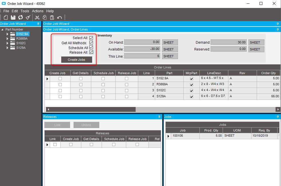

What’s the point of these Select All boxes inside Order Job Wizard? They don’t appear to do anything. Do I really have to individually check all the boxes in the grid view to make this thing work?
Its because your parts are MRP planned (that’s what the MRP checkbox is showing you) that you have to do each line individually. Essentially what its saying is normally these parts are MRP planned so by using order job wizard you are overriding that functionality which is why you have to create a job for each line manually. If these were not MRP Planned parts then you could use the select all functionality instead of each individual line
THANK YOU, we do everything MTS right now so I’m just getting familiar with the order job wizard.
