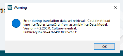

When all users log in to Epicor, this warning pops up. How can we resolve it?
微信图片_20230512101432
Regenerate the data Model and see if it goes away have you tried?
Sure , but it not worked.
open a call with support this is a weird one.
Does this occur to just the last user(s) or all? Is there consistency in which users get this error? I’ve seen a similar error when the translation file was corrupted. Assuming you’re using the multi-language module.
All the people occured that.
Verify that the regen actually updated the data model. There is an issue in 2022.2 where in some environments Epicor doesn’t correctly or fully update the data model when you run a regen.
