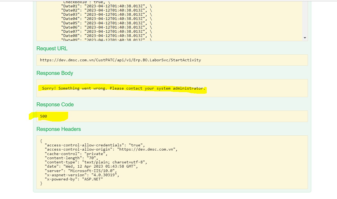

When calling API i get this message "Sorry! Something went wrong. Please contact your system administrator."

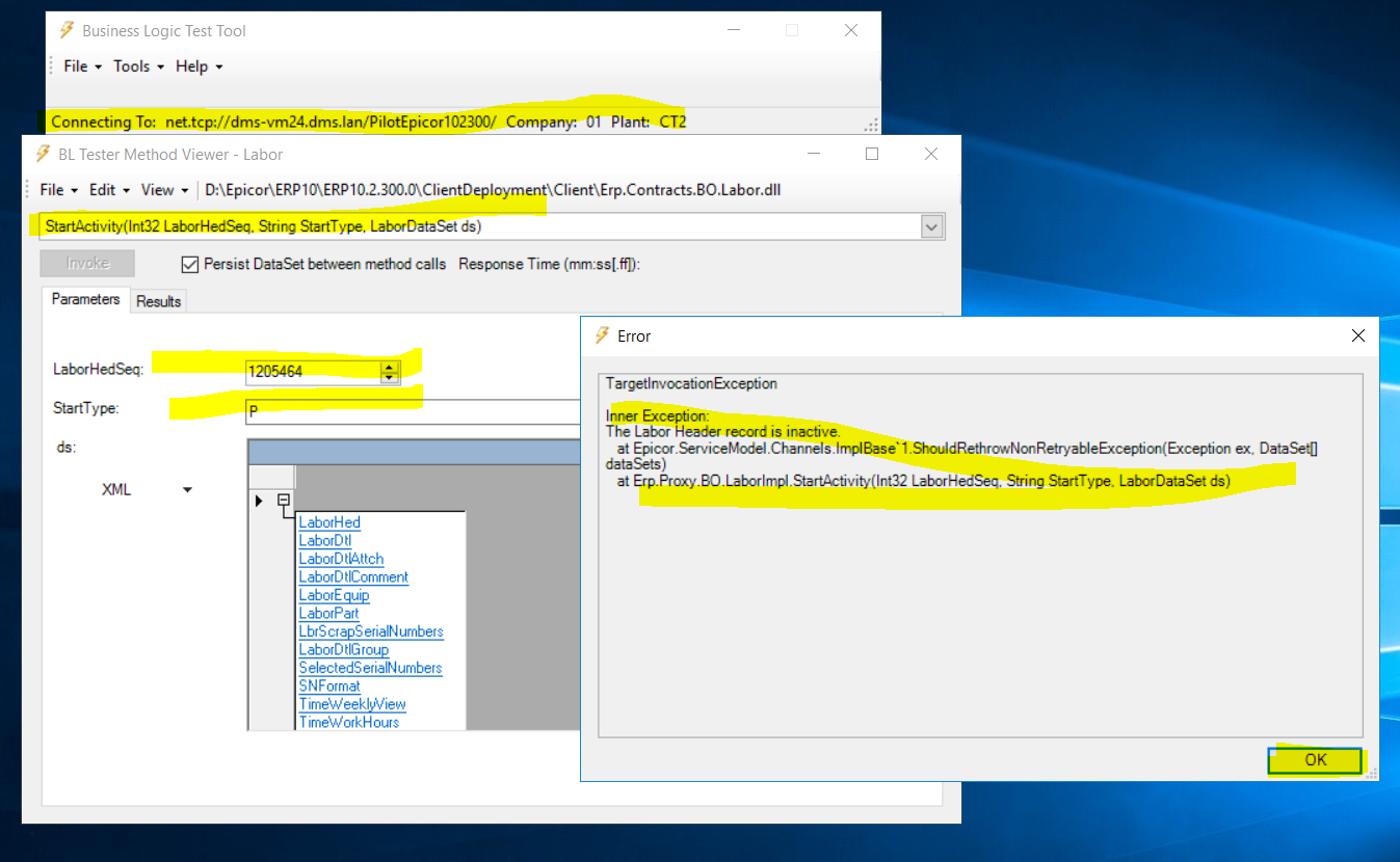

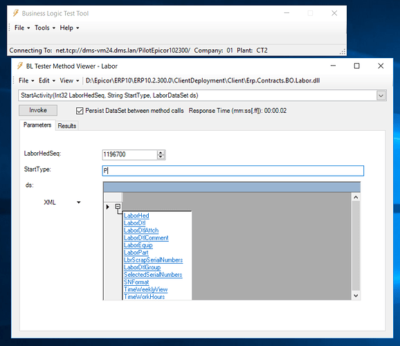

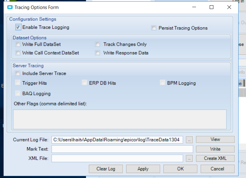

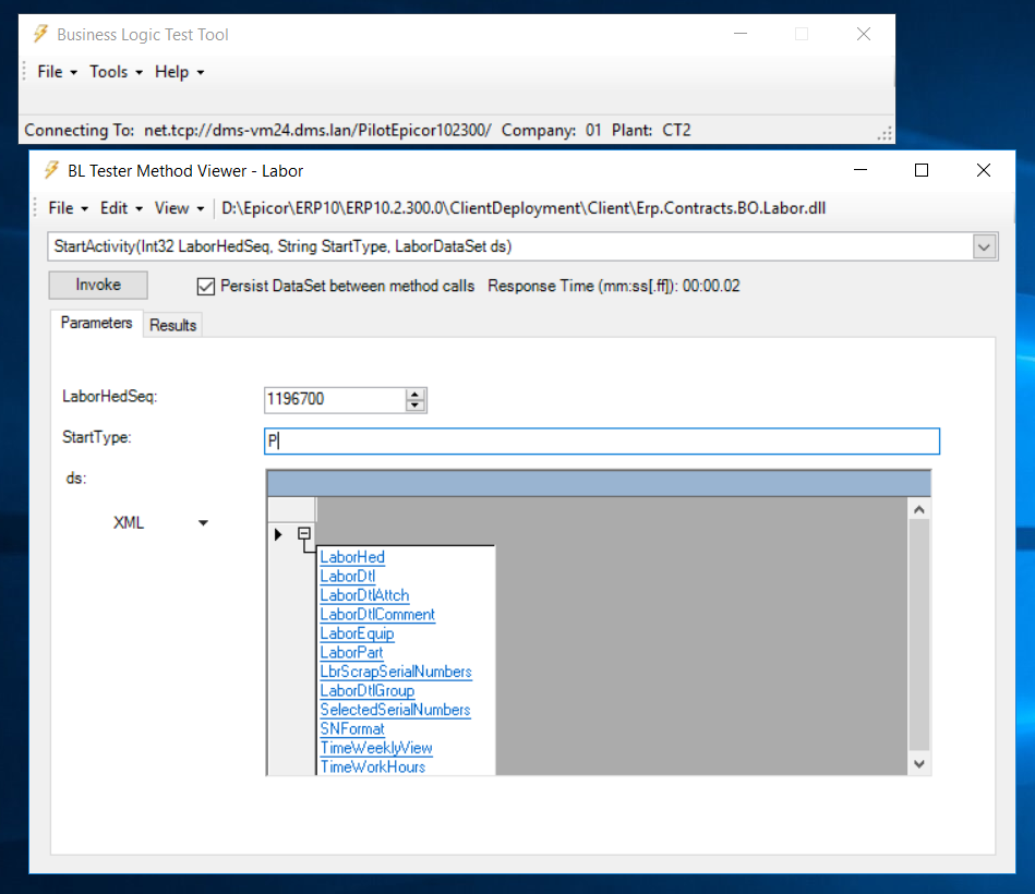

I use BL tester to test the method:
use tracing to find related methods as i do business
I want to test the methods through the API but there are some methods I get Sorry! Something went wrong. Please contact your system administrator.
Do I have to reconfigure the system or did I pass the wrong parameters?

Check the Event Viewer on your sever to read what the actual error is.
This ^
I have yet to try and do the web debug to see if it gives the same as the server, but I go to the server to see the error for now.
It doesn’t. The network tab shows the same system admin error. :roll_eyes:

I Using BL tester to test the Adapter’s function, I get this error

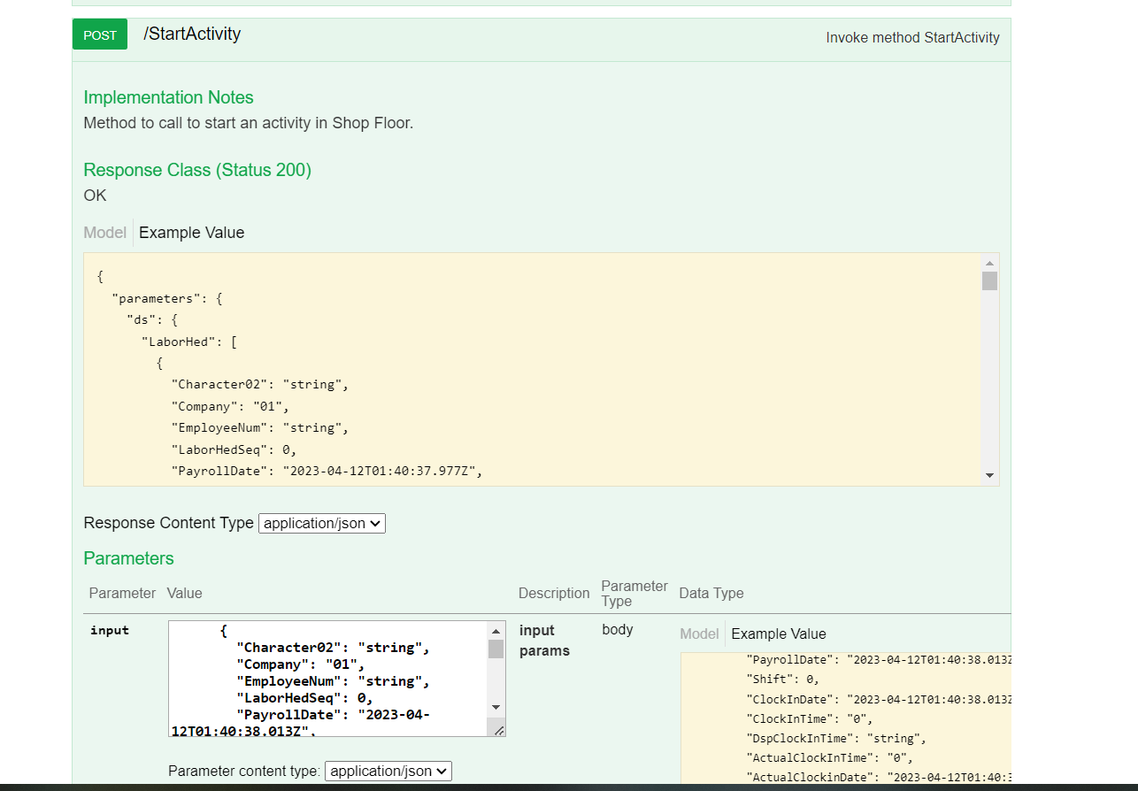

Has anyone tried using the web API to successfully call the StartActivity function for my reference?
this is the file passing Parameter
ParameterStartActivityP.txt (32.6 KB)

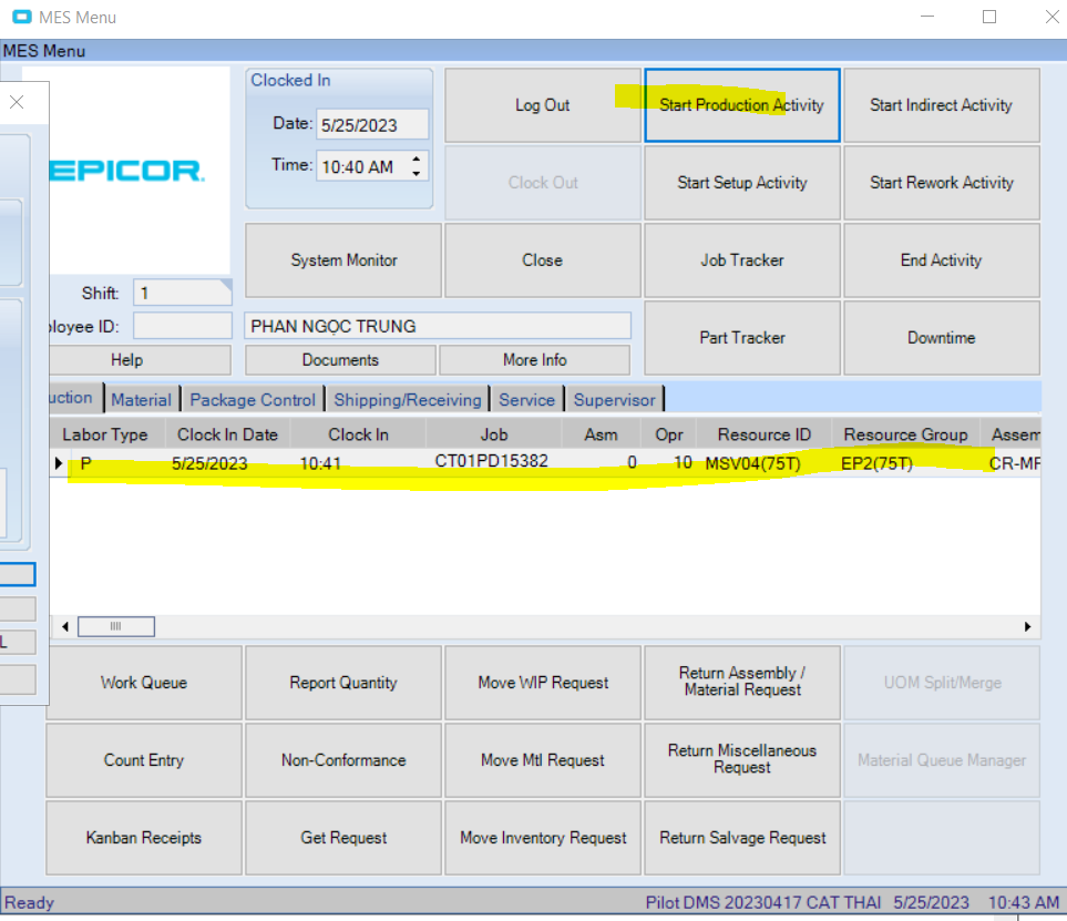

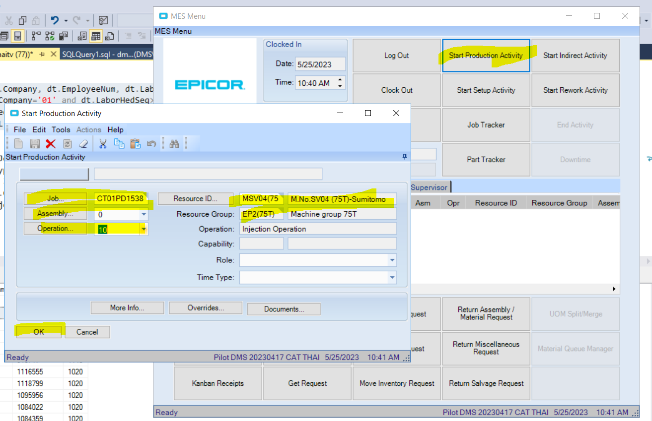

when performing transactions from MES
