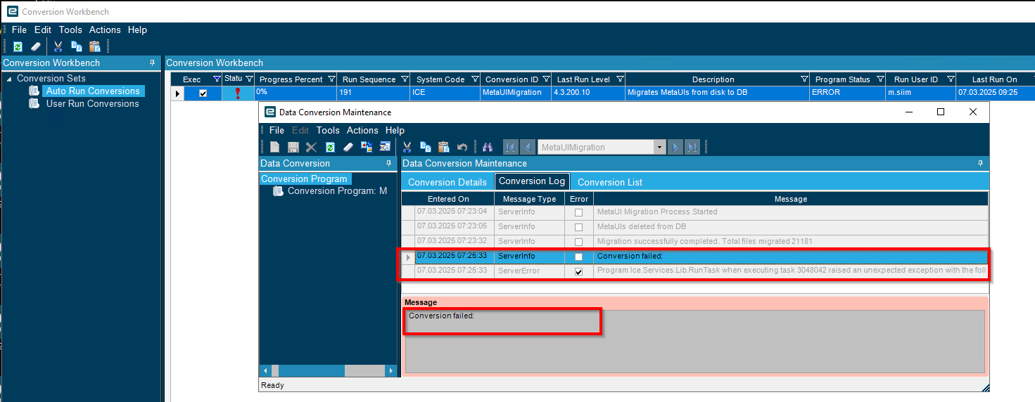

After the first launch, it will launch the Conversion Workbench.
All conversions are complete, except conversion 191 - “MetaUIMigration”.

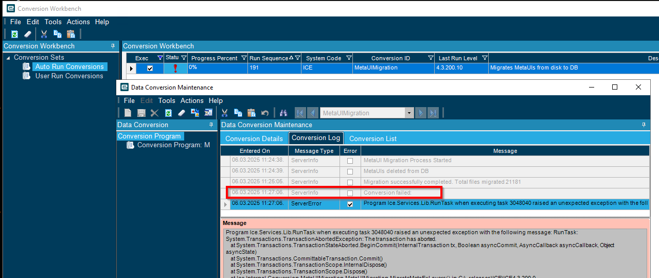

When I look at the log, the “conversion failed” line only says “Conversion failed” and the last line with error has a message:
Program Ice.Services.Lib.RunTask when executing task 3048040 raised an unexpected exception with the following message: RunTask:
System.Transactions.TransactionAbortedException: The transaction has aborted.

I also created an Epicare Case and sent them this error too, but there is no response at the moment.
Any idea how to resolve this?

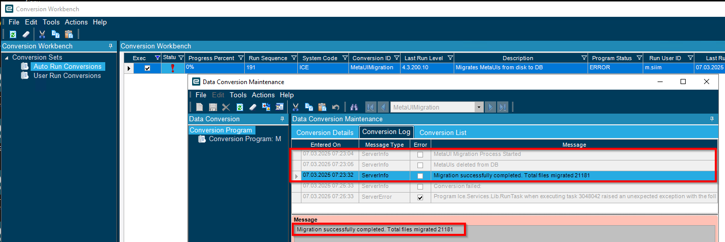

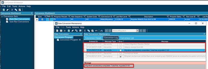

Interestingly the third last entry says it completed succesfully, then the next steps it fails…
When I look at the Conversion workbench → Conversion Log, it looks like MetaUI migration is successful.
But after that, it tries to do some conversion and the problem is in that conversion.
There is no specific explanation, what is failed! :frowning:
The last line has the exact same error message that I added to my original message.

Problem solved.
I found a “Predictive Search” for the JobHead.JobNum field. It was done before me (2017!). It had QuickSearch.IsShared = false, that’s why I couldn’t see it either, the person who did it has long since left.
I set QuickSearch.IsShared = true, then I was able to delete it under Predictive Search Maintenance and the problems disappeared.
