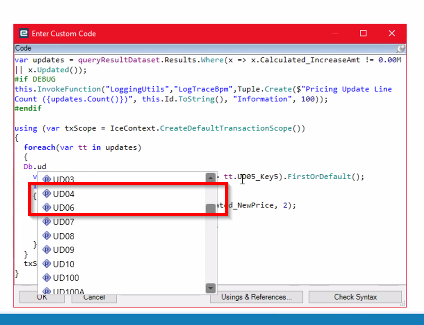

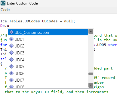

Upgrading to .13 we found a BPM error turns out UD05 is poofed from the context anyone else seeing this?
Did you see an error in the conversion workbench? or running tests…
as what made you check this UD table??

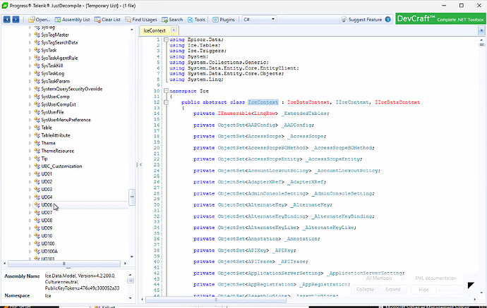

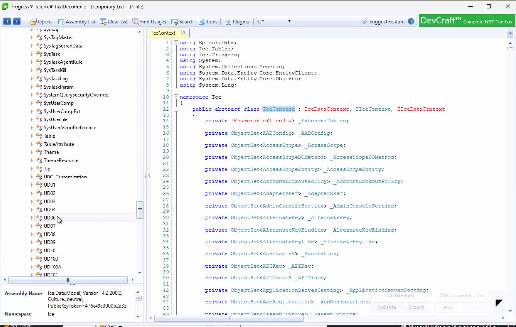

Back to OP … They just did a bunch of work (based on the release guide) on UD tables for DMT. Maybe they fixed it in .14
Conversion workbench error. Not in the datamodel at all. Did the ol regen and recycle for good measure still poof.

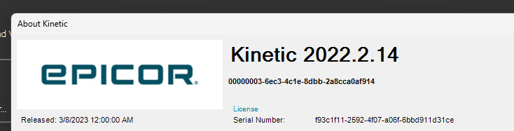

Saw that in the release notes for .14 but we can’t download it it’s getting picked up by A/V. It likes .13 just fine but full shun on .14 lol
I had the same problem yesterday. It turned out it was downloading fine, but windows security was zapping it once it was downloaded. I had to release it from quarantine to get it.
And yes the DMT issues with missing tables are fixed in .14.
Hey who changed my username. :eyes:
I just did the .13 to .14 deployment.
