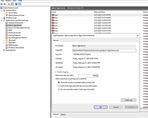

On your Epicor app server, in the event log you should see a Epicor App Server log under applications.
If it rolls over to quickly you can go to the properties of it and change the max log size and how it acts when its full.

That’s good to know that I can change the max log size, will look at it for our production server

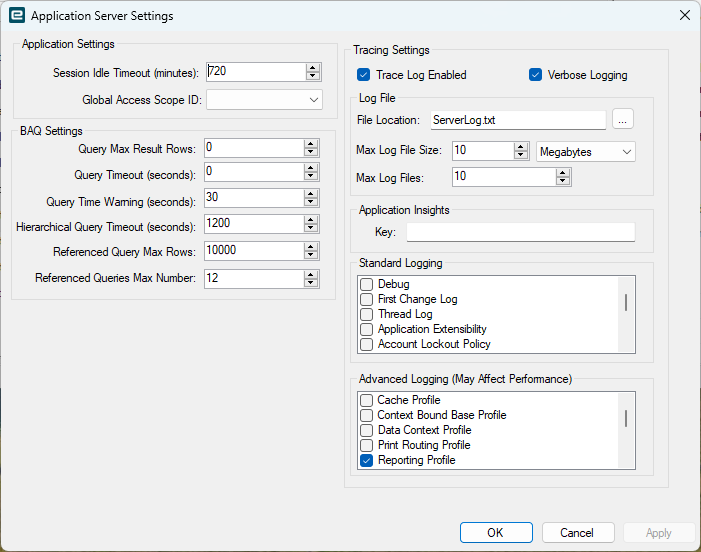

If you turn on server logs in the app server there will be log files you can use a log reader or np++ to search thru because they can be large. Depending on what flags you set you can get all kinds of info. I generate 800MB of logs a day.
I have license counts, bpm messages, all bpms called and all exceptions. In my test instances I dump the actual sql query that is getting run on the server. But in later versions there are some overflow issues with dumping too much into the logs, so I had to get more selective.

In earlier days if you wanted detailed server logs you used to have to update the appserver.config in the server folder of the specific application server. The logging ability was not that granular.
Now days with later versions the EAC extensions allow flexibility to change that without having to go to the file and change it.
You use the Application Server Settings from the context menu of the app server you are
Here are some screen shots for posterity. As mentioned the Application Server settings screen has changed between versions, don’t have an earlier screen shot than 2023.2.
2023.2 Application Server Settings
2024.2 Application Server Settings
