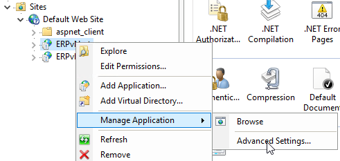

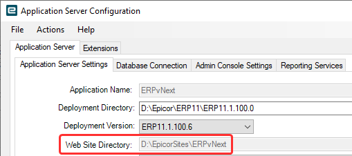

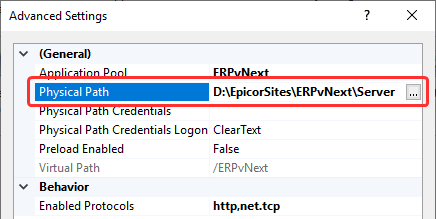

If it is a ZIP file, those are not the actual server files. You can find the actual location in the Epicor Administration Console (Application Server Configuration tool), or in the IIS Manager.
Admin Console / Application Server Configuration
IIS
Thank you for the know how. I was able to find it very quickly. I never thought to look under the Websites folder.
