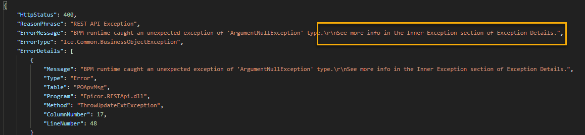

Where do I see Inner Exception details?
When sending a REST request to the POApvMsg service (for PO approvals), I’m trying out several different combinations of JSON payloads to test what works.
When trying to send a delete request I get this error:
I’m using POSTMAN, how can I actually see more info on the inner exception? Where is that? Is that available?
If you have access to the server, you can probably look into the Windows Event Viewer. In the folder ‘Applications and Services Logs’ you should be able to find the related Epicor folders.
Thank you I found errors in the event viewer corresponding to the errors I was getting. Alas, it had a lot of details but none of it useful for my troubleshooting. Thanks for the tip!
