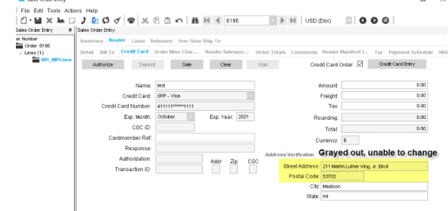

When you check the Credit Card Order checkbox in the Order Entry | Header | Credit Card tab (OrderHed.CreditCardOrder), it populates fields like OrderHed.CCZip, which are displayed in a box called Address Verification.
Where are these fields populated from? When we update a customer’s billing address, their old address keeps showing up in these OrderHed.CC* fields.
I guess there could be a use case for the address associated with a credit card being independent from the customer’s billing address. The problem is that the OrderHed.CC* fields aren’t editable in Order Entry, so the address of the first successful transaction becomes permanently associated with the card. Hopefully the solution is as simple as customizing the fields to be editable.

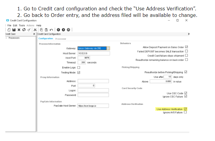

Indicates whether you want to move the Street Address and Postal Code for the credit card transaction into the Street and Zip fields for the credit card processor.
When you select this check box, you activate the address verification fields (Street Address and Postal Code) on the Order Entry - Credit Card sheet. Users can then enter information in these fields.Knowledge Page - EpicCare.pdf (107.8 KB)

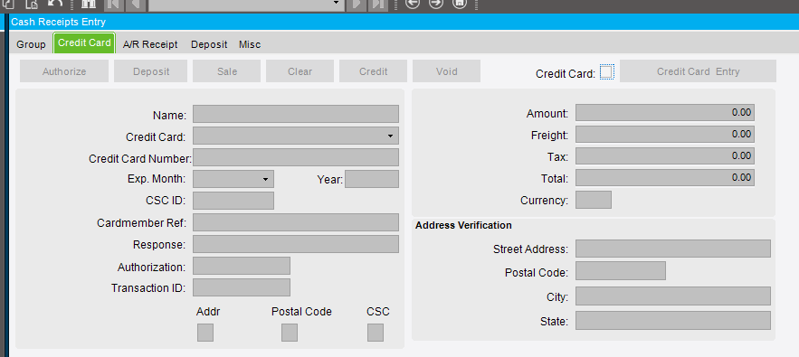

Checked the box in Credit Card Configuration and saved. Created a new test order to make sure the old one wasn’t carrying any old settings. No difference. The street address and postal code remain un-editable and are still populated with the old, incorrect ZIP. The city and state are editable, but they always were. The same fields are editable or not in Cash Receipt Entry.
