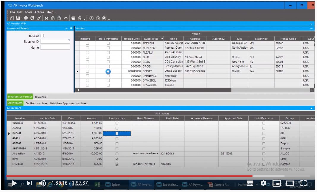

Where to find AP Invoice Workbench?
Someone in our company watched a video on youtube (Epicor 10.2 Comprehensive Demo - YouTube) that shows at 1h35 an Epicor Menu called ‘AP Invoice Workbench’. I can’t find any info on EpicWeb or anywhere online. It doesn’t seem like a license problem since it doesn’t seem like there is one for that (we have the Account Payables license).
Does anyone have more info on this menu?
I do not beleive that is a standard Dashboard. More than likely someone built it or it may have been on one of our sales images as a demo aide.
Looks like one of Epicor’s Role Based Dashboards that is included in the Training\Education Database.
They are usually located under Executive Analysis. I have never seen them installed as part of the standard installation as they are part of the Epicor Training DB. In the past I was successful in exporting some from Train and importing them in Live. They are meant to demonstrate what can be done with Dashboards. You should be able to see them if you login to your Train DB as ‘manager’ or ‘epicor.’
Thanks, I’ll look into it. I don’t really have access to the training environnement right now but it might be a good solution if we find it there later.
