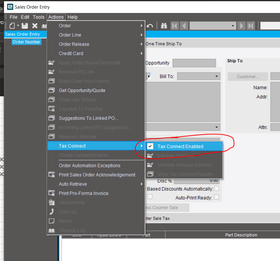

Can anyone point me in the direction to locate this fields EpiBinding field name?
Do a trace when you turn it on / off it should tell you what field gets updated.

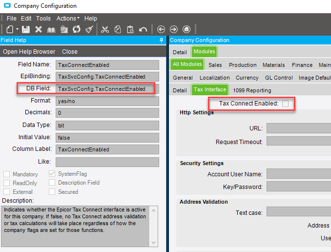

I found that one, but I was trying to control specific orders to use tax connect or not. I submitted a case and Epicor said that field is not a true indicator that the tax connect is enabled so I’m dead in the water until I can figure something else out. Thanks for your help.
Assuming Kinetic works the same as E10 - If the ReadyToProcess field is not checked, then it won’t send it to Avalara (Tax Connect).
