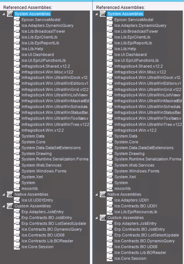

I’ve added Erp.Adapters and still the same error.
Assemblies referenced are as follows:
I see JobEntry in there, and I BELIEVE JobEntryImpl would be how it’s called in code.
Am I missing something else here?

I think you are missing the Erp.Adapter.JobEntry as an assembly reference.
I’ve added Erp.Adapter.JobEntry and still no luck. JobEntryImpl is the correct syntax or would that have changed between 10.1.600 and 10.2.200?

This one has broke again with the upgrade from 10.2.200 to 10.4.400.13.
The code is the same in both, but the assembly references look different, with .400 having 3 different Native Assemblies compared to 10.2.200’s single entry. Please see below, left is the 10.2.200 that works, the right is 10.2.400.13 that does not. Same error message as at the beginning of this thread.
