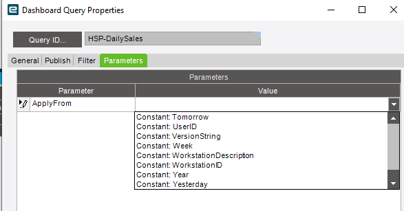

I believe that it’s this part in the dashboard. Right click on the query and go to properties. I haven’t done it myself yet, so I’m not sure how it works.
As far as I can tell, that only lets you bind a parameter to a constant, not a tracker field. But I would love to be wrong about that.

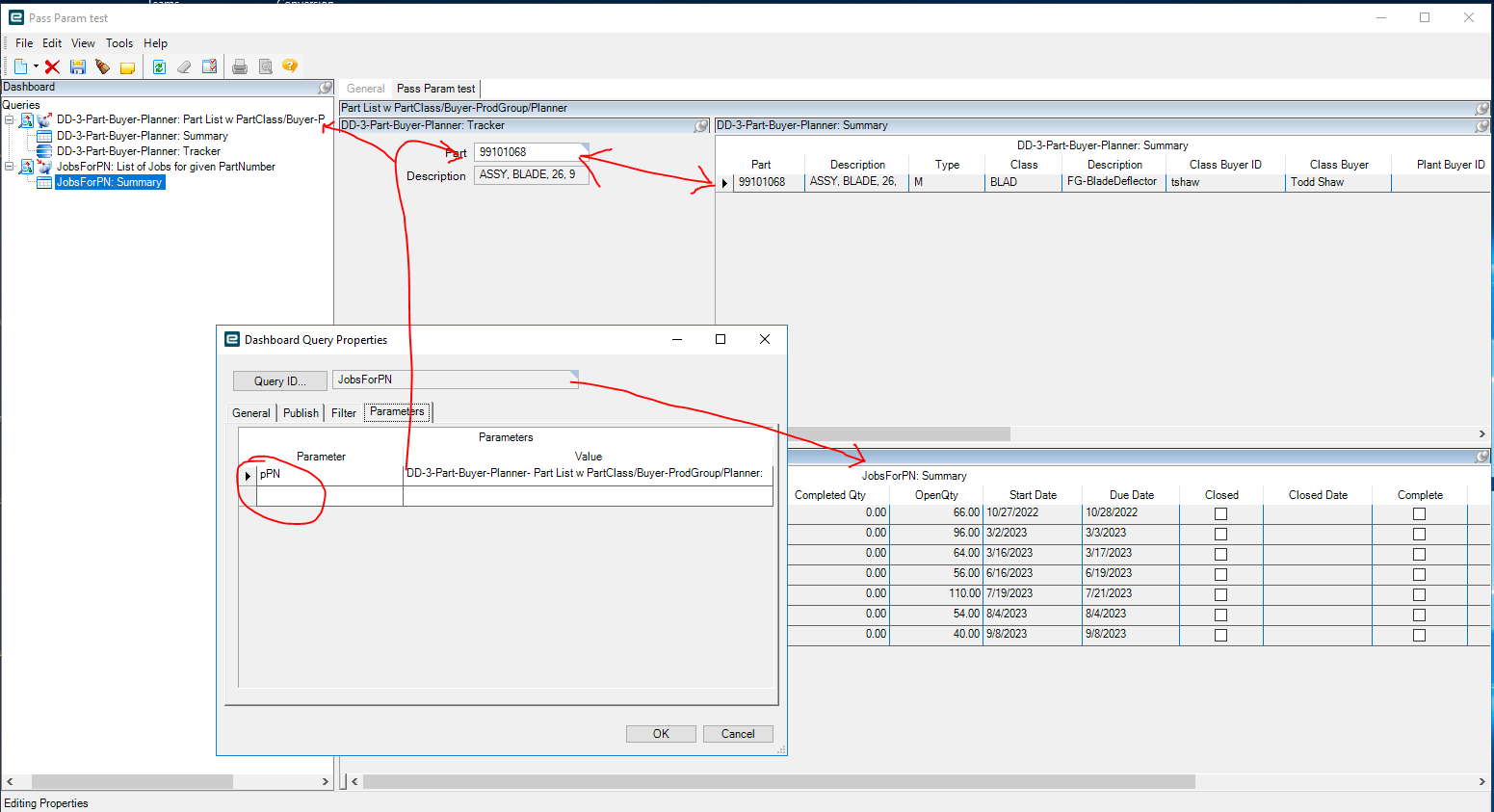

Looking for an example but I believe that you can use a Published field as a passed parameter.

Sorry for the 5 year old looking graphics Part number is published, pPN is BAQ Param for second Query

Ahh, I see. In my example, the tracker is tied to the top grid ( Prompted input to fill the top grid. )
The Part Number( actually from the first Query) is what is published to fill the bottom grid.
