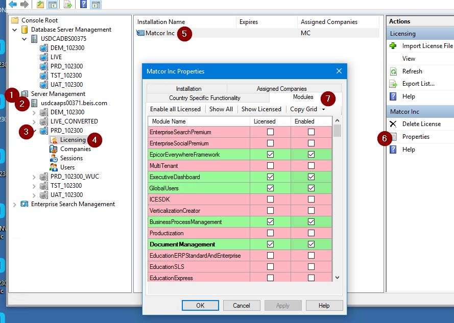

EAC.

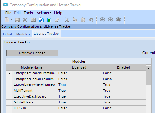

And for completeness, SaaS users can use the Company Configuration and License Tracker:
Thanks Calvin!
That was it!
