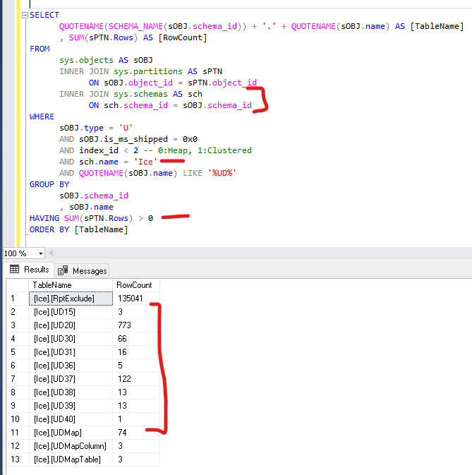

Just tested it with a little variation, still not perfect, to make it a bit more accurate on Ice.UD tables.
SELECT
      QUOTENAME(SCHEMA_NAME(sOBJ.schema_id)) + '.' + QUOTENAME(sOBJ.name) AS [TableName]
      , SUM(sPTN.Rows) AS [RowCount]
FROM
      sys.objects AS sOBJ
      INNER JOIN sys.partitions AS sPTN
            ON sOBJ.object_id = sPTN.object_id
	  INNER JOIN sys.schemas AS sch
			ON sch.schema_id = sOBJ.schema_id
WHERE
      sOBJ.type = 'U'
      AND sOBJ.is_ms_shipped = 0x0
      AND index_id < 2 -- 0:Heap, 1:Clustered
	  AND sch.name = 'Ice'
	  AND QUOTENAME(sOBJ.name) LIKE '%UD%'
GROUP BY
      sOBJ.schema_id
      , sOBJ.name
HAVING SUM(sPTN.Rows) > 0
ORDER BY [TableName]
thanks again.
