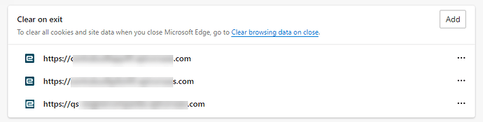

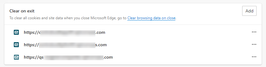

We run Kinetic UI in Edge browser and we set the URL for Prod, Pilot, and QuickShip Prod in the Clear on exit. This cleans the browsers cache and we have much fewer issues with WSOD and other things.

I like the idea of setting to clear on exit. Thank you!
