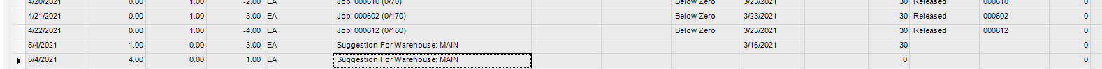

Why am I getting Multiple releases on a po for same order by and due by dates
I am Trying to refine our PO suggestions, And have been for quite some time. I feel I am close, But I am struggling to figure out why I get a suggestion for the same part, 2 times, with the same order by and due by dates. Why does it not simply combine them?
My days of supply is set to 30, I don’t have anything in lot sizing. I have not found the right area to stop this from happening…
Thoughts?
I am no expert on this, but at what date does your time phase go below 1?
this is a better full view. 4/19 it goes negative. (again)
I have tried regening MRP multiple times also, just to throw that out there. I have looked at a few other parts with the same issue, and I am starting to think that it makes a release for getting back to min, but then another release for what needs to go to jobs. The thing I find weird is this is not a buy direct part. It is pull from stock. So it should just combine the release.
That’s what I was going to say. Are these jobs that are listed MRP jobs? Or are they in production?
The 20 day lead time is definitely working, but I would think if you ran an MRP right now it would say you need to order the 1 at least to get it in 10 days past the point of going under minimum.
These are all in production jobs that were created by MRP. I would agree that the amount I need is not wrong, I just don’t get why it doesn’t simply combine the releases when they’re identical. Ultimately we are going to do that anyway when we make this po, but it is odd it is not doing it now… The screen shot above was taken right after a full MRP regen. And it didn’t change it.
I think the suggestion for 1 is the Days of Supply amount away from when you go below minimum. If you change the DoS to 35 I wonder if it would combine it … or maybe enter something into your safety stock to see if it plans differently.

so I can make that happen on alot of parts, BUT sometimes that is not realistic at all, and honestly I thought days of supply would take care of that. It kinda does, but maybe it changes the releases based on type of demand? so job demands create a release, and below min creates a release?
Min levels and multiples simply do not work for us as we do not want alot of stock of certain parts. many of these are buy to job, but I cannot mark them as such because I need them to sit in inventory to wait on the job to be available to work.
checked this, it is not checked on any part class. Do you think it would be related to TYPE of demand? Job vs Below stock min? kind a dumb way to do it and it drives both our purchaser and vendor nuts.
It’s because your jobs are farther apart than your days of supply. You have 30 days of supply, and the last job that goes on the first suggestion is more than 30 days before next job. So if you were really worried about expensive parts sitting on the shelf, you would separate the PO’s so that you didn’t have to buy the last one until you needed it on the job. I think that the order that things are displayed is wonky because things got pushed to the same day, but they wouldn’t have the same delivery date on the PO.

i would agree, except the po does write the same way for both releases. order by date 1/1/2021, due date 2/1/2021. It is not pushing the second release at all so vendors get all confused, “why do you have the same due date?”. This isn’t just on 1 part, it is on a bunch.
Yeah, and it’s letting you go below zero. You should run PO suggestions with logging for just that part and see what’s happening. It’s like it is failing to reschedule the PO. Or doing it poorly.

This issue is simply why i get suggestions that is required to order and be here at the same exact time bu t for 2 releases. Why does it not combine them so I do not have to do it manually.
@recelect I would also look at the log to see why the suggestion date is 5/4 when you go below the min of 1 on 4/8. I think that is the bigger problem than the two suggestions.
