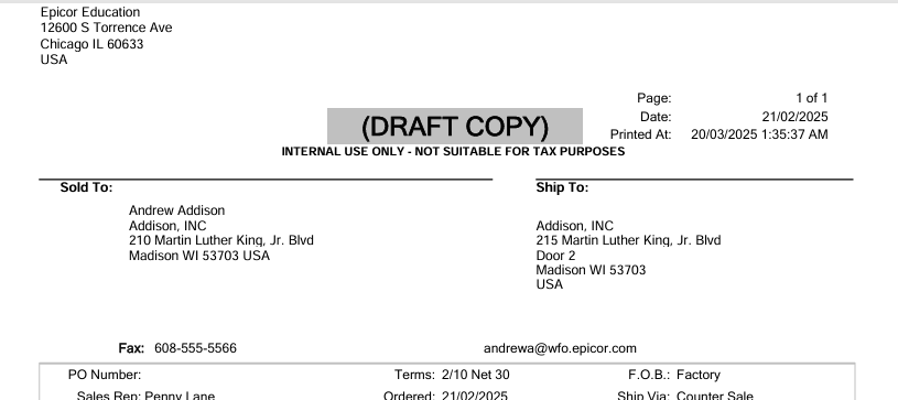

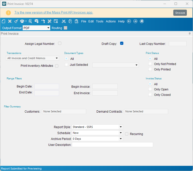

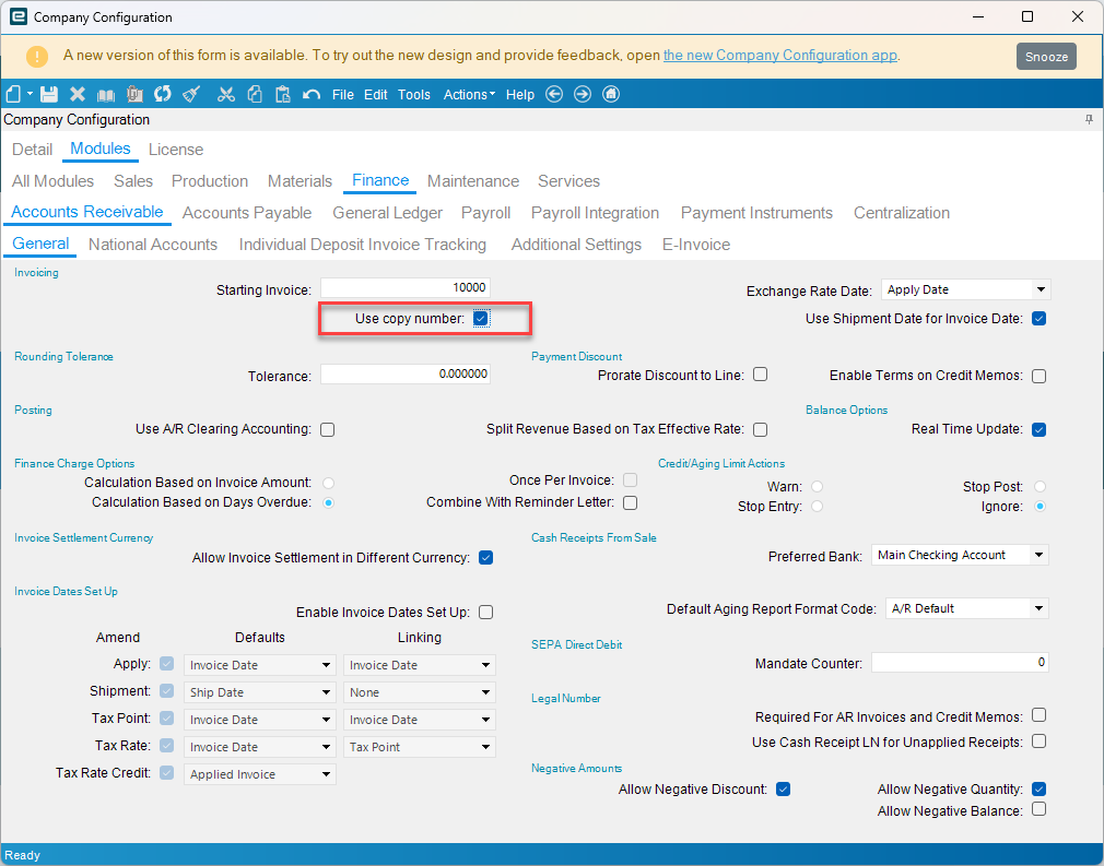

If you enable use copy number in company config.
Then the draft Copy checkbox becomes available on the Invoice print program.
Which then yields this on the report
So, wow, I had no idea about that.
But… I assume that’s still the honor system, correct? It looks like it’s a tool for printing drafts but does not force it for unposted invoices, right?
Pretty sure it will work for both as you can select it from the invoice tracker and the Mass Print… I think the print invoice form in AR invoice Entry is the same.

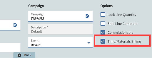

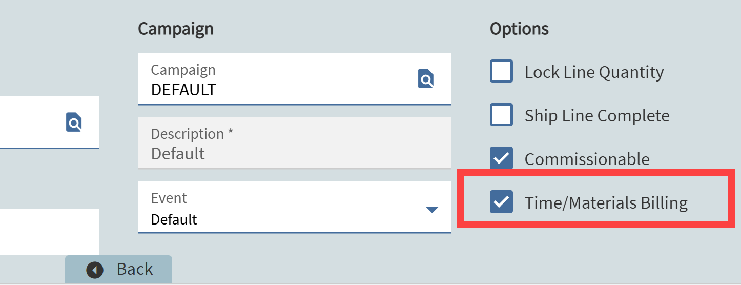

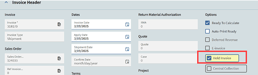

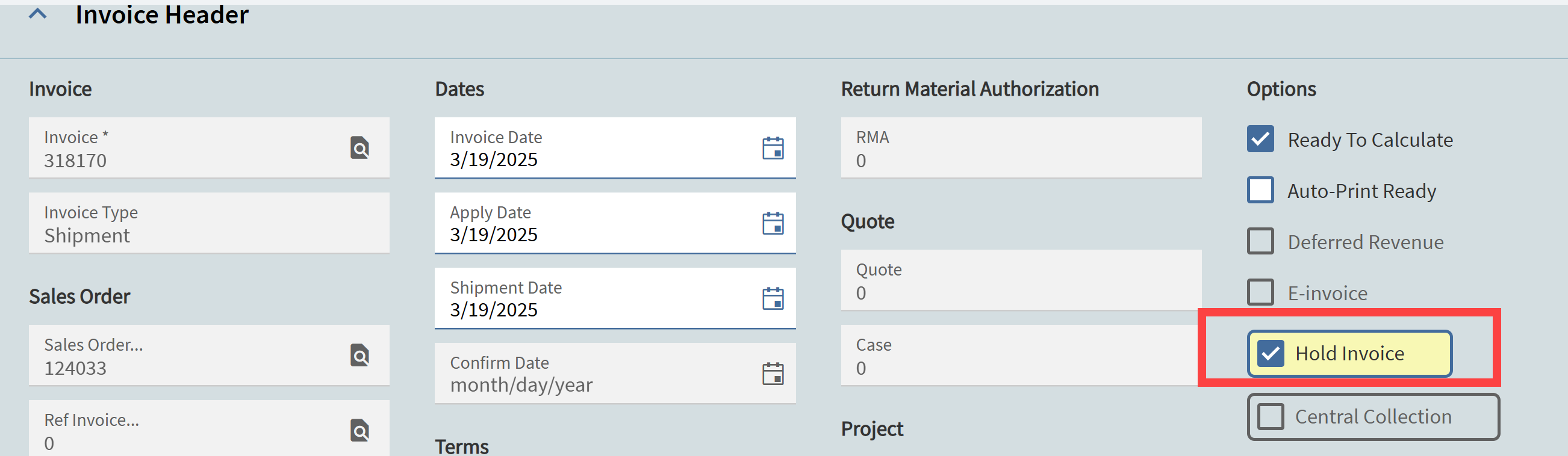

On a related note - if you want to make sure the invoice is correct prior to posting it.
Set the time/material flag on the order line.
When the invoice is created the invoice is placed on hold automatically and can’t be posted until you take off the hold. You can print either a draft copy or “real” invoice before taking it off hold.

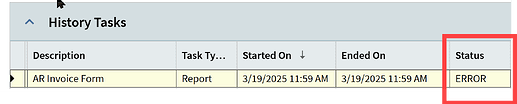

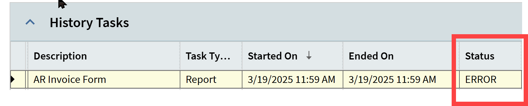

No lines found error…
