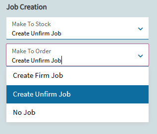

I’m not 100% sure, but I think the Job Creation settings in Site Configuration > Inventory > General Details allows you to choose to create firm or unfirm jobs. Changing those to Create Firm Jobs would seem to indicate that MRP wouldn’t create unfirm jobs for you.
Not that I recommend that, because of how MRP will delete and recreate unfirm jobs upon regeneration and/or net change when there are demand changes. Seems like only ever having firmed jobs would create a lot more work to constantly monitor the validity of all your jobs.
