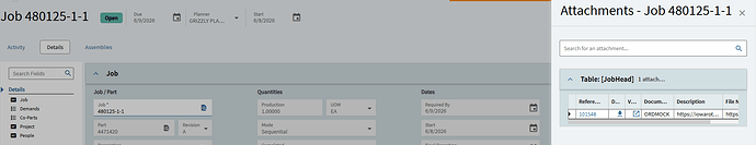

I’ve been searching through application studio to find the Job Entry Attachments slide out that appears when you click the paperclip.
I don’t see it in the application map for Job Entry and have run out of ideas of where I should be looking. My goal for finding it is to look at the View attachments function in the grid to see if I can add it into the Doc Maintenance slideout for job documents in MES. The only option that is listed there is Download…

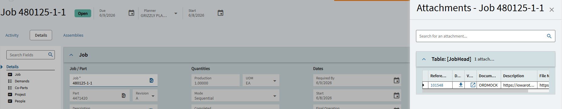

I’m new to finding my way around the dev tools. I don’t see any network call when I click either the download or the view control in that attachments grid. I do see activity in the edge agent log. Even if there is some voodoo script that is calling the edge agent, shouldn’t that be seen as network traffic?
I think this discussion in academic, since I have found that the button on the screen labeled Download that I didn’t push because I only wanted to view the attachment actually opens the attachment and doesn’t actually download it. :man_shrugging:
