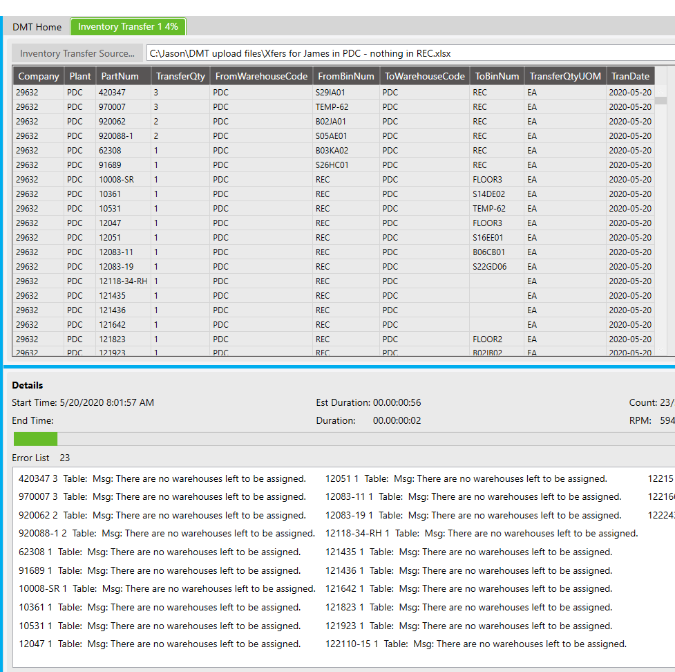

Why does DMT care what site I am in in Epicor?
In regular Epicor (not DMT), I am logged into the MfgSys site.
If I try to DMT some inventory transfers for a different site/plant (PDC), it errors out with “There are no warehouses left…”
But if in regular Epicor I log into that site, the DMT works.
Why…?
Oh, and I know some of the bins are blank. I get why those fail.
I think DMT assumes the last site you were last logged into. To get around this, I believe you can just add Plant as the first field to the DMT file
So… the second column isn’t enough?
Sorry but I didn’t notice your screen shot… I would guess that is enough

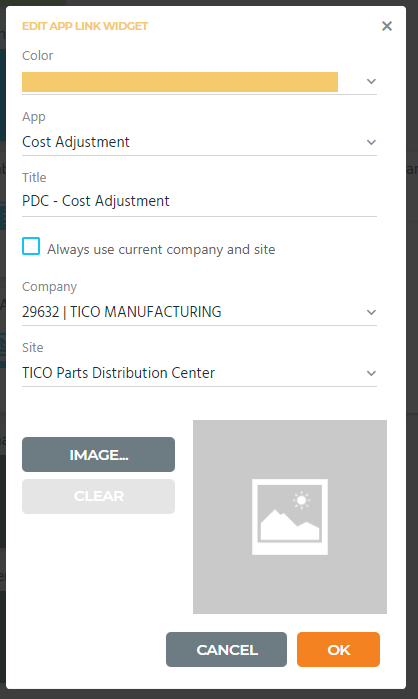

Yeah, and while that is mighty annoying, I can at least customize my tiles to open in a specific site. Can’t do that with DMT.
Of course, it’s not like I want to make a version of every tile for every site. I think you had a post about that a while back, choosing open-with for a specific site, or something.

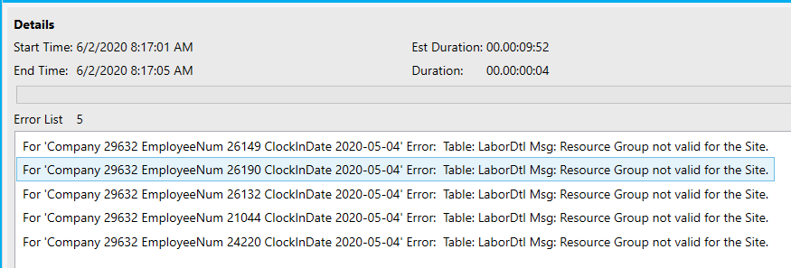

Today I was trying to upload labor (TE Labor Detail No Header) and got the error - technically, “Resource Group not valid for the Site.”
