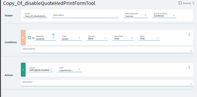

I am wondering why if the quote is closed but still quoted the button is disabled. The rule’s only condition is on the quoted flag. The out of the box print button does what I expect it to but mine dose not.

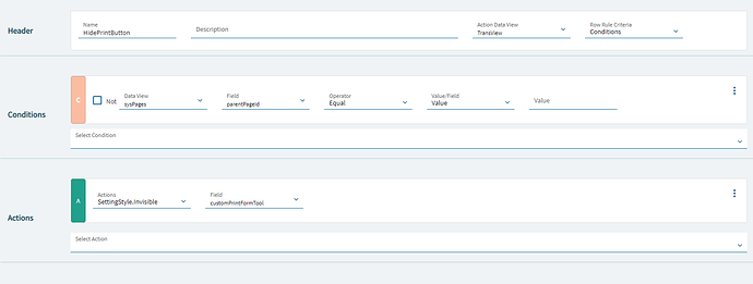

It seems to work when I bind it to TrnsView instead of QuoteHed. I just ended up creating an extra rule to hide the button on the landing page.
Yeah… can’t explain it. Just wondering if when you close an order or a PO, the OrderHed and POHeader records “close” and everything goes to read only on the form. Whether “tools” tied to those datatables inherit some artifact of that and behave oddly.
