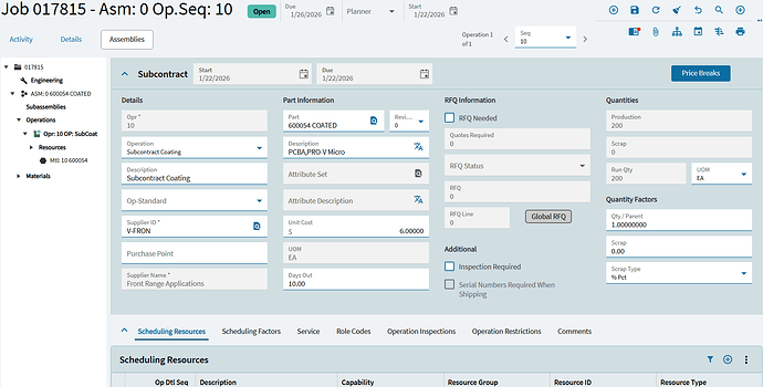

After running MRP, there was no suggestion created. There were similar jobs where the PO suggestion was created.

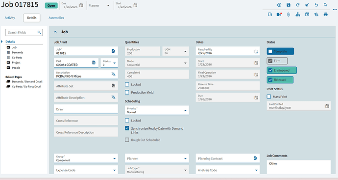

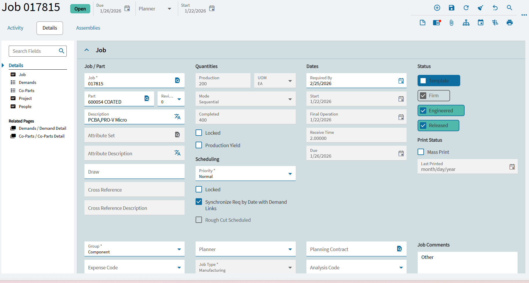

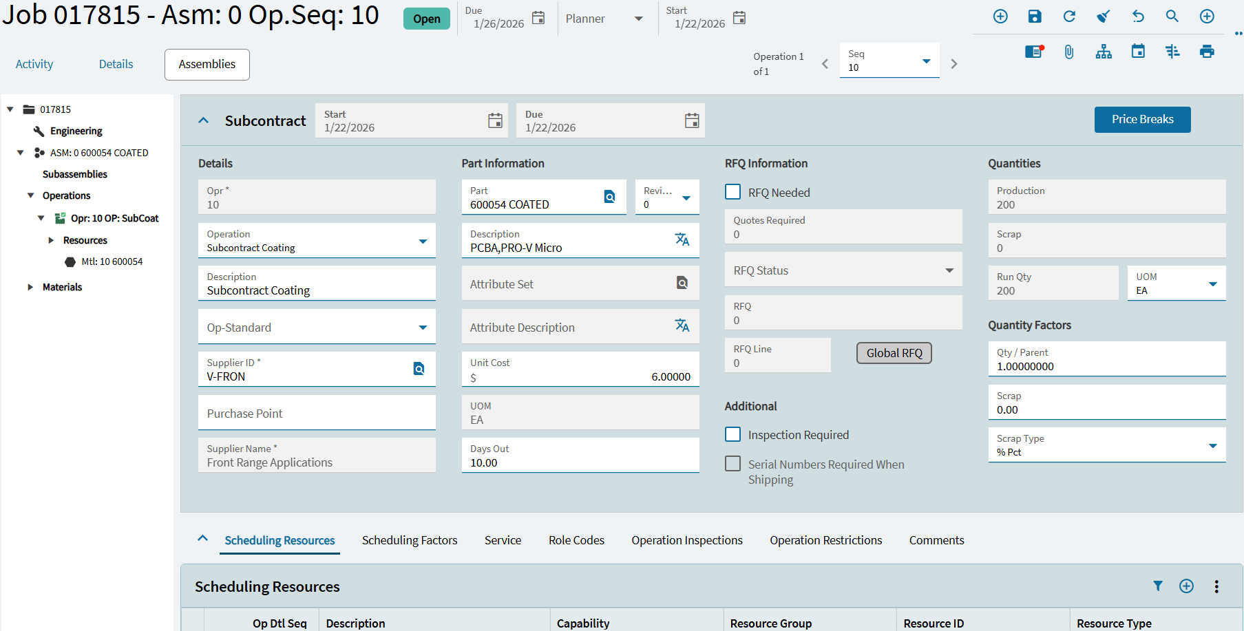

What’s your Op10 screen look like?
Am I missing something?? Op10 already looks complete:

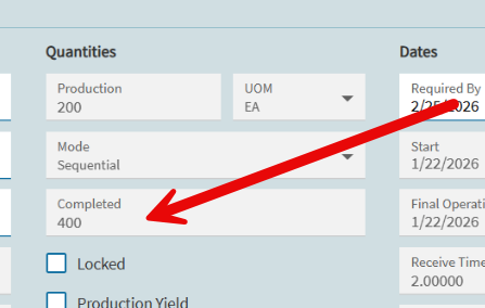

Good catch! it says complete 400 of 200.
Kelsey Grammer Problem GIF by Paramount+
Ok, I was wondering if it was due to that operation already being completed. So if an op is completed it will not generate a suggestion?
Imagine how many suggestions you’d have if all completed operations got suggestions! :wink:
