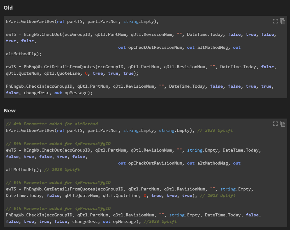

If they add a parameter to the widget, it will not adjust the fields to allow for that.
There’s usually only one code block and “Check sytax” finds the problem.
Here are some examples. Epicor added parameters to these calls. When I’ve had these method calls in widgets, the widget breaks, and doesn’t allow you to simply add the missing parameter. You have to create a brand new widget to get the added parameter calls. With the custom code, we just simply add a , and the parameter. Fixed.

In fact, I seem to recall a time when Epicor changed the signature of a method that we had to update in dozens of places.
And nobody suggested it would. But for some changes, they could do some fixing up. Recompiling directives/functions will find syntax errors but we still need to test logical functionality.

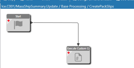

This is the typical BPM at SG.
By “Nobody” you mean Epicor. Because they say that Widgets upgrade cleanly.
All they would have to do to make it 1000% better is allow for a refresh of the signature so that you can fill in missing parameters.
