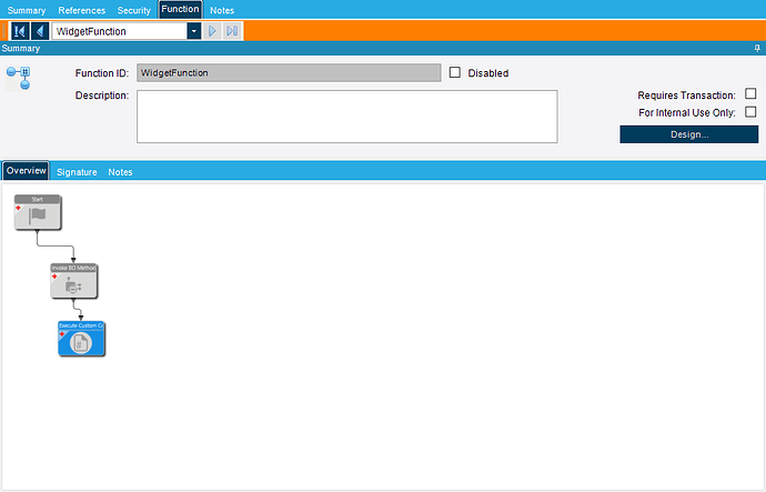

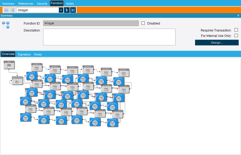

I attempted to re-create a large widget Function and then do the same exact function without widgets. As examples goes it isn’t a great one, but it serves to illustrate the problem we are trying to solve is simple
  1. Retrieve a record from ABC Code using GetByID
  2. Assign 37 fields into this ABC Code record.
Widget:
Code It Generated 900+ LOC:

        [Epicor.Customization.CustomCode]
        private System.String A012_SetFieldAction_ABCCode(Erp.Tablesets.ABCCodeRow item)
            return ("A");
        private void A013_SetFieldAction()
            var query = ds.ABCCode.Where(row => !row.Unchanged());
            foreach (var item in query)
                item.ABCCode = this.A013_SetFieldAction_ABCCode(item);
        private System.String A013_SetFieldAction_ABCCode(Erp.Tablesets.ABCCodeRow item)

Non Widget Method:
Code It Generated 118 LOC:
using Epicor.Customization.Bpm;
using Epicor.Data;
using Epicor.Hosting;
using Epicor.Utilities;
using Erp;
using Erp.Tables;
using Ice;
using Ice.Contracts;
using Ice.ExtendedData;

                case 1: // Execute Custom Code 0
                    try
                        this.A002_CustomCodeAction();
                    catch (Ice.Common.BusinessObjectException ex)
                        this.RememberException(ex);
                    return Epicor.Functions.PredefinedStep.Exit;
                default:
                    return Epicor.Functions.PredefinedStep.Unknown;
        private void A001_InvokeBOMethodAction2()
            this.CallService<Erp.Contracts.ABCCodeSvcContract>(
                bo =>
                    System.String _arg01 = this.A001_InvokeBOMethodAction2_arg01();
                    ds = bo.GetByID(
                        _arg01);
        private System.String A001_InvokeBOMethodAction2_arg01()
            return ("A");
        private void A002_CustomCodeAction()
            foreach (var x in this.ds.ABCCode.Where(row => !row.Unchanged()))
                x.ABCCode = "A";
                x.ABCCode = "A";
                x.ABCCode = "A";

Neither of these options is particularly elegant, but here’s a breakdown of their Big O efficiency/complexity metrics along with other relevant considerations. Big O complexity is a way to describe how the performance or scalability of an algorithm changes with input size.
Big O Categories:
  • O(1) – Constant Time:
    This means the algorithm’s performance does not depend on the size of the input—it runs in the same amount of time regardless. For example, a function like GetDateTime() always returns the current date and time in constant time, whether today, tomorrow, or next year.
  • O(n) – Linear Time:
    Performance scales directly with input size. The larger the input, the longer the algorithm takes. For instance, a counting loop:
    CountTo(10); // Takes less time
    CountTo(100); // Takes 10x longer
  • O(n²) – Quadratic Time:
    Here, performance scales exponentially with input size. For example, a standard sorting algorithm might iterate through a list multiple times, resulting in a time complexity proportional to the square of the input size. Doubling the input roughly quadruples the work.
Aspect Code Widget
Number of Dataset Iterations 1 (single pass through ds.ABCCode) (m) (one pass per field, (m = 36) in this case)
Number of Assignments (n * m) (all fields assigned in one loop) (n * m) (one assignment per iteration per field)
Number of Methods Invoked 2: A001_InvokeBOMethodAction2, A002_CustomCodeAction (2 + m): A001_InvokeBOMethodAction2 + (m) field-specific methods
Code Jump Points Minimal: 1 return per switch case High: (m) return points, one for each field-specific case
Workflow Complexity Simple: Linear execution through 2 steps High: Linear execution but with (m) additional workflow steps
Big-O Complexity (Dataset) (O(n)) (O(n * m))
Big-O Complexity (Workflow) (O(1)): Workflow has minimal state transitions (O(m)): Workflow has (m) transitions
Overhead per Field Update Minimal (loop runs once, condition per field) High (new loop and query per field update)
Code Reusability Moderate: Harder to reuse logic across fields High: Field-specific logic encapsulated in methods
Code Maintainability Low: Single large method harder to debug High: Modular field-specific logic improves clarity
Readability Moderate: All logic in one place but harder to trace specific fields High: Clear separation of logic per field
Testing Simplicity Low: Harder to isolate and test individual fields High: Easy to test/update individual field logic
Anyway I’m not necessarily arguing one way or another and I don’t want to get into another religious war It was mostly morbid curiosity. But here are some of my own observations.
  • Code First processes the dataset in a single pass, reducing iteration overhead, while Widget First iterates once for each field update, increasing execution time with each individual widget at a rate of m*n (once per widget)
  • Widget First is more modular, with each field update encapsulated in its own method, making it easier to debug or extend compared to the centralized logic in Code First. However this is abstracted to us by the software
  • Code First minimizes the number of function calls, while Widget First has a higher number of method invocations due to its field-specific design and a billion return points leading to some nice spaghetti code (which is admittedly abstracted by the software)
  • Code First scales better with an increasing number of rows in the dataset
  • Workflow complexity is minimal in Code First with fewer jump points, whereas Widget First has higher complexity due to many workflow steps and returns.
  • Code First provides significantly better performance but you sacrifice the ease of maintainability by having to write code.
  • Widget First Generated over 900+ LOC more isn’t always better
  • Widget First 118ish+ LOC Less isn’t always better, more compact code generally means more inherit complexity in a single method.
I guess what I am trying to illustrated is that while yes Widgets can be convenient you are sacrificing efficiency in some cases. Similarly by writing a bunch of code you may be making a more efficient BPM or Function but you are sacrificing maintainability. So Right tool for the Right Job.
As Confucius said “Do not use a cannon to kill a mosquito.”
