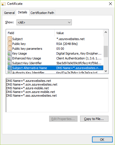

Here is how wildcard is set for Azure web sites -
Subject Alternative Name contains both *.azurewebsites.net and *.scm.azurewebsites.net
