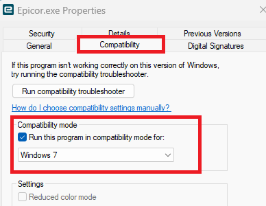

Old thread I know but wanted to put this out there in case someone runs into this.
Right click on the desktop icon and go into ‘Properties’. Select the ‘Compatibility’ tab. Check mark 'run this program in compatibility mode for: and select ‘Windows 7’ and then save.
This will allow your E9 client to run on a Win11 machine.
