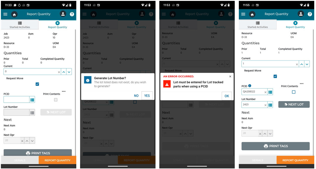

When reporting quantity on a job for a lot tracked FG, if I want to move my contents from my first operation into a PCID the system is requiring a lot number. My job runs for days and when each pallet comes off, it needs to be it’s own lot/PCID/traceable unit. When using report quantity and selecting a PCID, the lot number becomes mandatory. When trying to move this pallet using the material request queue, there is an error that “this part does not require a lot number” and no action can be completed.
Has anyone run into this and have suggestions?
